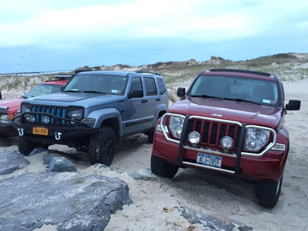

Never even noticed that you're on the island. Where on LI? I'm always down to meet up. I have a small group with a few KKs in it, that meet up pretty often and love to hit the beaches. This is me and one of the members KKs. She has a 3.5" tommudd lift and 265/75-16 Kumhos
