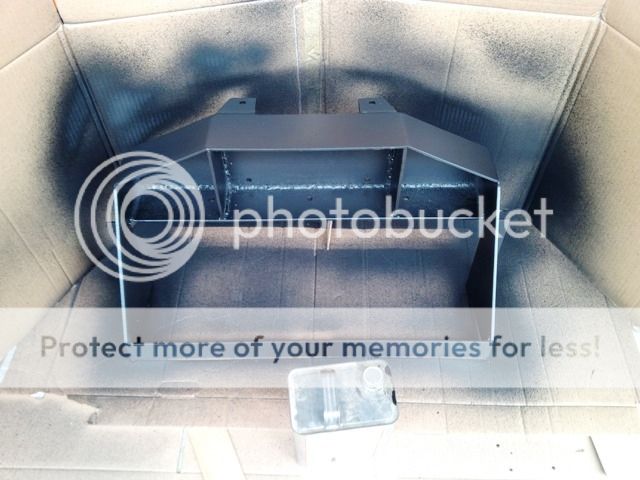

Something similar to what I made for my KA.
I know the KK skin is different, but you may be able to glean a few ideas from my build.
My basic design. Only two pieces of 1/4" steel here, the back plate, against the cross member, is welded on to the plate. The rest is one piece cut and bent.
All boxed in for strength.

Something like what you have there is the type of look I would like to get.
Nice work, thanks for sharing.

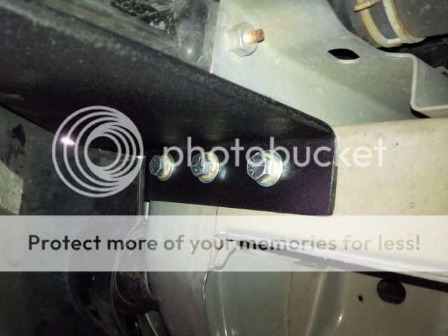

Unfortunately, any winch plate you add will have to use the same mounting holes the shackle tabs are mounted in. Detours, ATH, and mine all use those holes. Mine uses the 2 stock holes on the bottom of the frame plus a third I put 2" further back.
I also have 3 bolts going into the front of the the cross member.
All my holes/bolts are also backed with an additional 1/4" plate inside the frame and also inside the cross member.
