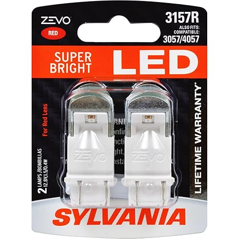

Well I figured it out with trial and error
So for #1
These work very well. Slightly brighter than stock bulbs, nice difference of brightness between regular tail lights and brake lights. Also they respond faster than regular bulbs when you tap the brake, the LED brake lights light up quicker, which is great to give drivers behind you more reaction time.
Stock 3157 Bulbs
12.8v / 14v
8.3w / 26.9w
LED 3157 Bulbs
12.8v / 12.8v
0.4w / 1.5w
Buy these

did the Zevo lights and work, two color fronts but the solid state flasher you have to live with hyper flash and I get random windshield wiper on right turns....

I did those light in the rear. Back up, turn and brakes and the euro conversion.
I also did color changing signals in the front. Unfortunately the liberty doesn’t have traditional flashers under the dash so you will get hyper flashing “fast flashing”. I also get random wipers on right turns. No clue why but I’m sure its a voltage thing with the LED lights.
Hope that helps.
You can see them in my posts in the tech section.
