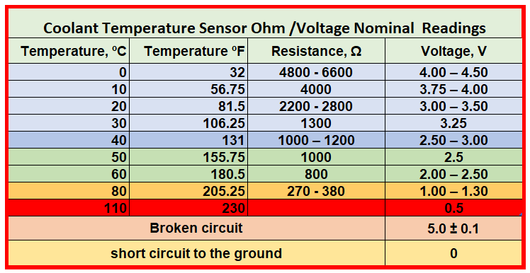

So I just replaced the motor in my 11 kk last weekend because it dropped the seats, also replaced plugs, wires, coils, air intake, cats, o2 sensors crank sensor and muffler. Now I am getting codes for high voltage on all 4 o2 sensors and IAC rpm higher than expected, also it will not go in closed loop. A few searches have me thinking possibly the coolant temp sensor may be screwing things up but can't seem to find the ohm chart to test it. Any help or ideas would be great, thanks in advance

Found this, cannot guarantee it is a perfect chart for your Jeep. :wink:
Maybe able to use it as a guide?

Thanks man. Hoping that sensors bad and solves the issue, otherwise im not sure what the problem is
