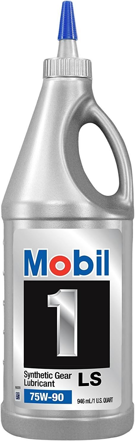

75W90 Synthetic Gear Oil for normal everyday driving
75W140 Synthetic Gear Gear Oil if you do any towing or live in a very hot environment and want a little extra protection.
