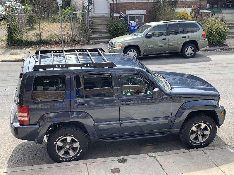

The stock unsagged height of the 08 Liberty was 18” from the center of the front wheel to the bottom of the fender and 19” in the rear. If you can get it to about 2.5 to 3” over that, your ride will be so much better and your CV’s will be able to handle the angle. Even 3.5” is ok, since you have JBA UCA’s.
I’m running at about 3.5 to 3.75” of lift these days with an older JBA 4” adjust a strut kit with JBA UCA’s. I do have some unwanted traction control engagement when turning slow 90º corners, but otherwise it rides great. I’ve only had to replace one CV in more than 120,000 lifted miles.
3.5” lift with 245/75R16’s
Jeepin By Al 4" Lift Kit
BFG KO2’s 245/75R16
Full MOPAR skid plates
