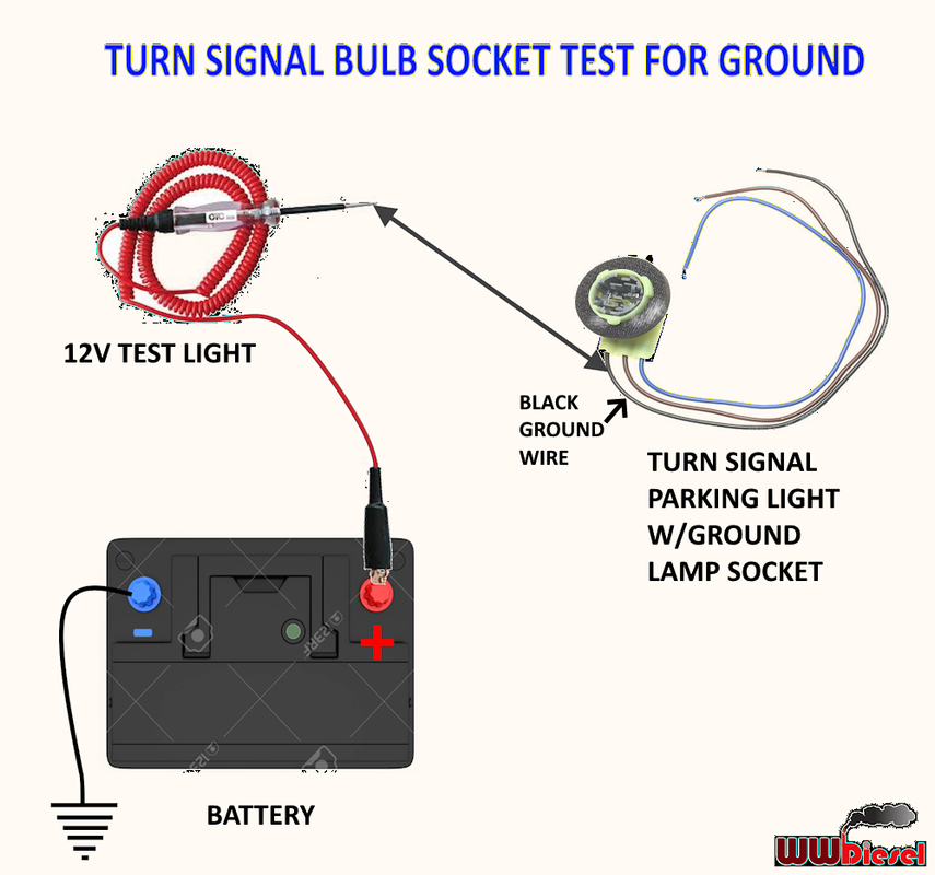

Definitely sounds like a bad ground issue.
Check the ground wire going to the bulb socket and make sure it has a good solid ground.
You can do this using a 12v test light by connecting the light to the 12v + battery post and then touching it to the ground terminal on the bulb socket.
Most times the ground wire will be black. You can look at a wiring diagram to confirm circuit wire colors.

Just wanted to let you know your diagnosis was correct. Got a new test light and checked out the 3pins in the connector. Center was parking, outer white wire was turn signal and black ground. Checked hot leads first, no issues, tested ground per your instructions, no go. Added a new ground wire, both issues fixed.
Thanks again for the help.
