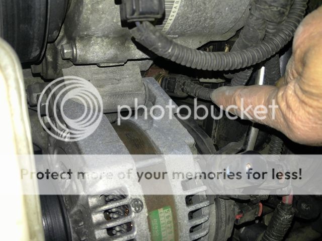

Some good info, I will try the fuel cap thing if I have the opportunity. Also where exactly is the temp sensor on the engine to unplug?
Thanks.

Front center just between the generator and A/C compressor. Round black plug, 2 wires.

 Post subject: Re: 2009 Liberty random hot start problem.
PostPosted: Thu Apr 06, 2017 9:27 am
Joined: Fri Mar 31, 2017 1:08 pm
Posts: 7
Thank You!

jimd118 wrote:
Thank You!
Your welcome. It was kinda hard to get a Pic with my big hands in the way. LOL
