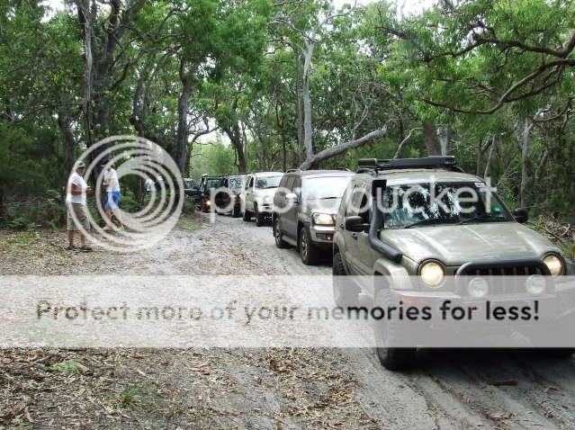

just some picture's of last weekend
on the trail

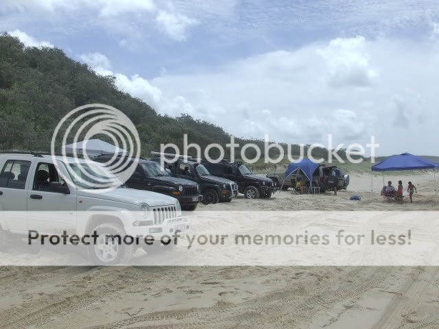

lunch time
