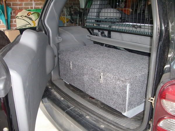

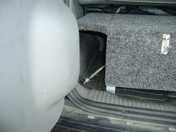

My latest KJ purchase, thanks for the draws Glen (ghewkins), there great. I've added a little grey paint to the exposed wood.
(Nice KJ you got too Glen, not too many out there with the 3.5" Sub lift & I hope you find this site)

PostPosted: Sun Jan 20, 2008 4:58 am
Posts: 970

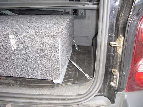

Looking good Chris. Pity about the turnbuckles blocking the side spaces - can you find another way to hold them in place?
Only thing that comes to mind atm is a right angle bracket that I can screw to the draws & lock onto the tie down points some how. But yes it does limit some of the space, I was thinking that a cheap K-mart fridge would slot in there just fine but the turnbuckle will stop that.

PostPosted: Mon Jan 21, 2008 4:26 am
Posts: 1786
Thats great.
you should be able to pick up some shelf brakets from Bunnings and use them , that would hold it down nicely and give you back that little bit extra space..

cmohr wrote:
Thats great.
Good buying Chris
Thanks mate, I do like to spend :lol:
How do you think you would attach the bracket to the mounting point, perhas a small D shackle?

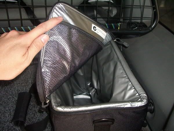

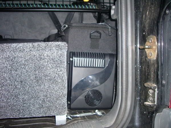

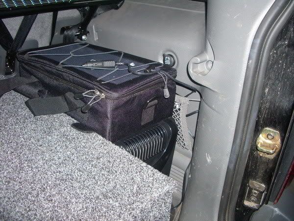

I just bought a small 24L soft bag fridge for day trips, $34 at K-Mart. I now need to make a small stand for it to sit on, the rear is sitting on the wheel arch. It's a tight fit but works just fine.
I'll test it out tomorrow, just need to remember not to leave it connected without the engine running. Other wise it will be flat battery time. Anyway for $34 I'm happy.

PostPosted: Sun Jan 27, 2008 3:33 am
Posts: 493
Location: Sydney, AUSTRALIA
Looks good.
I think Jaycar have a battery protector you might be able to run it inline so if the voltage drops to 12.3v it will auto cut out.
Need to be extra careful about turning it off since it's a thermo-electric cooler.
They usually suck 60watt's 24/7 (5a/hr).

ed. wrote:
Looks good.
Talk to you about that tomorrow :?
I re-mounted the turnbuckles on the drivers side, now the cooler can sit nice and low 8)
