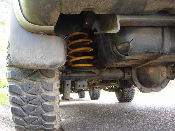

Yes folks, I have replaced my sagging rear OME948 coils in the rear with a set of custom made King springs. Basically I always carry a bit in the boot area, and with packing up for trips and wotnot, the rear coils just haven't stood up to it, even in the beginning to get a decent lift to try and level the KJ I had to put in 2 TJ 10mm packers, and then soon after a 3rd 10mm packer was added to keep the rear up at about 545mm from hub centre to flare. That was 30mm of packers and the OME948 Heavy duty coils, not really impressed by this and the fact that it was very sloppy and when I packed the car for a trip the car sat another 35-40mmm lower again.
So Stu installed the new coils Saturtday morning, I made sure we had a decent weight in the back, I normally have a drw system in the boot that itself weighs about 18kgs, plus a fridge, 2 steel jerry cans full (thats another 50kgs) some random stuff weighing about another 30kgs, as well, I have a tow hitch with fuel tank skid, and on the roof a steel basket (17kgs) So, packed up to and extent (not as much as when camping mind you), but enough to cause the nomal problem of the rear dropping down to 530mm from hub centre to flare. We took out the old coils, removed the 3 packers from each side and installed the New Supercoils, IMMEDIATE RESULT. with the load in place the KJ sat back up at 555mm and the front close behind at 550. Good ride with the load in, then when I got home I removed most of the weight, normally when I would do that the car would jump back up the inch or so it normally would, but with the supercoils, it raised only about 8-10mm, which was also a good thing, as the worry was that the ride height was great for "loaded" but was it going to be too high for "unloaded". The answer is no, very acceptalble ride height even unloaded, but, yes, stiff ride, but these coils are purpose built to "hold up" and that they do.
Will be installing a set of Super travel shockies sometime this week that will give awesome flex in the rear, and will post up some pics as soon as I have tested it on some tracks next weekend. But at this stage I believe the problem of the ever sagging rearend it's self, is at an end.

A pic or 2 of cmohrs rear coil thanks to STU.
cmohr
I don't know "how" many inches of lift to call it
Its just really really good.
And the 31/10.5/15's love it!!!!!
Oh and I still have the fridge and draw system in the back with all my recovery gear, and remember I am hanging a full size 31/10.5/15 Mickey T MTZ off the back as well. This is not a lift for the general man in the street as he would not like the ride/feel of it, this is to travel and have a load, whilst retaining full rear flex, something the polyair system does not do.
I love it cmohr, I just took my draws out (carrying them around for the last few weeks). I will have to get a set of these rear Super Coils but just not sure when. I'd even buy them over a new CB :lol:

Ed as you may or may not know, Kings make OME, the heavy duty King spring is basically the OME948, and a lot of folks have no issue with the OME, CRDSTU himself still has his original OME948's in the rear of his, and it has plenty of lift with no sign of sag. But as I and CDKJ have found the issue comes from compression and overcompression, when theres a load in the rear and you drive on those corrugated outback roads for 100's or in my case 1000's of km's they just don't hold up. We live and learn and with any luck this will solve my hassles.
You may also see in the pics CD posted up of the rear coils, the nice big bumpstops I now have at the base of the coils. They are about 35-40mm high and are made from a high desity rubber hammer, they will also help as I will now not get the overcompression I did before, and the limiting of flex I get from the extra bumpstops will be more than compesated for by the longer coils and soon longer shockies. All this together with the 31/10.5/15's and taking off the front swaybar, this should be an even more capible 4x4 than it was before.
