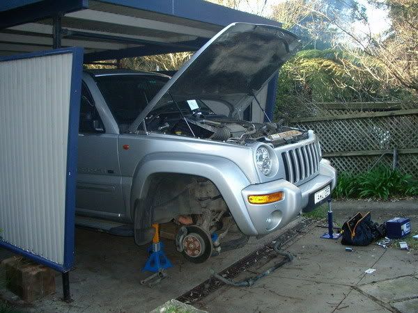

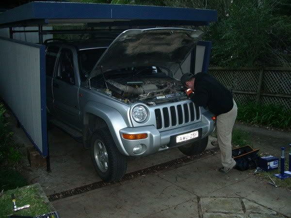

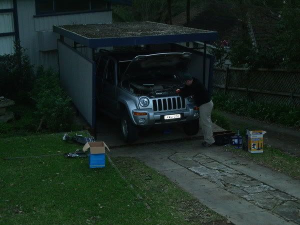

It was an early start and bloody cold, however it was a good day. So we got into it and installed another great lift from CRDSTU. Pedders had some trouble getting the front assembly sorted but 2.5hr later we were good to go :lol:
What happened Ed tried you on the phone a few times today but no go, hope your OK mate.

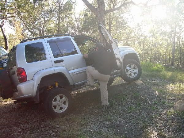

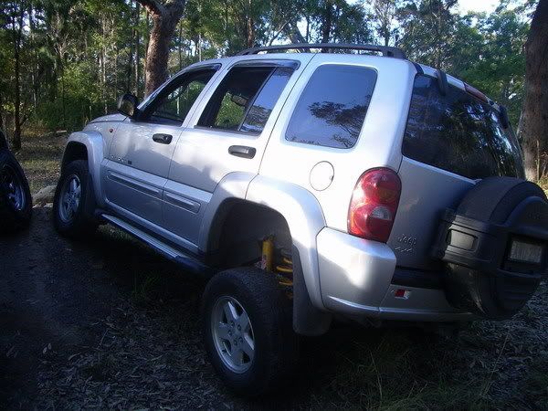

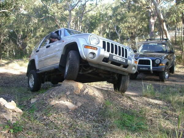

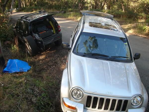

And Pictures of some flex and some seriously old street slicks

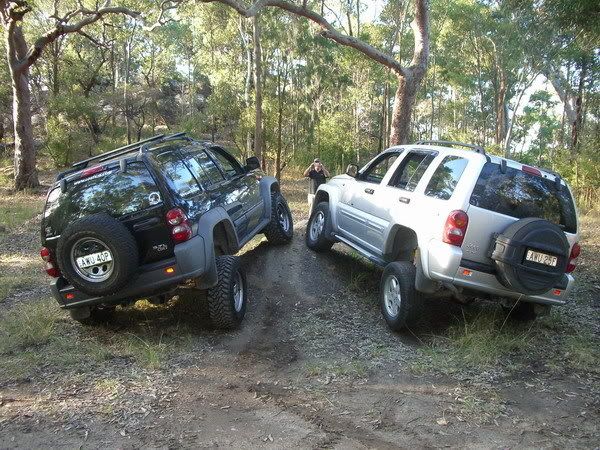

Man it was a long way up... ;) hope every likes this one it really shows off the flex - oh and my reasonably large arse!

It will feel like a different beat again with come larger rubber on. Those stock thin walled tyres combined with no wheel alignment do add up to a strange handling characteristic, pls get it aligned asap!!
