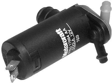

Bought the pump from autozone for $29.00. It has dual outputs for the front and back like the stock unit. This one has spade connections, no OEM connector required. Part is from TAAP inc. This unit was stock on 97 and older Ford Expeditions.
Found a 32 oz Nalgene polypropylene bottle Just the right size for about $9.00 from U.S. Plastics
Decided not to use the rubber grommet that came with the pump and instead drilled a 5/8 hole in the side of the bottle. This generates a bit of heat and melts the plastic, so took some sand paper to the opening to clean it up. The hole is almost too small, takes a bit of force to get the pump neck in. Once installed, I pulled it out half way and applied silicone sealant to the pump neck. pushed the pump in and then applied sealant directly between the pump and the bottle.
Letting this cure tonight, will install it sometime this week. In the meantime, I've stripped the old connector off and installed spade connectors to the wiring harness and cut the rubber tubing to the correct length for the new location. I haven't figured out if I need a bracket yet. I think that all I need is a flat base with a lip and a zip tie the neck to the radiator support where the old cap was attached.

I am doing this finally, broke the output on my pump... thanks to bugnout, I found the OEM ford (motorcraft) pump on amazon for $22 (free shipping). Part# WG-302 for anyone who wants to shop around more.
amazon.com/Motorcraft-WG302
