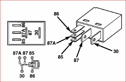

If you remove the relay for the fuel pump and put a jumper from terminals 30 to 87 in the cavity in the Power Distribution Center with the key in the ON/RUN position, the fuel pump should run if all other wiring is connected correctly and the fuel pump has not froze up.

Is the fuel pump relay activating when you turn on the key? You should be able to hear it click or put your finger on it and feel it close.
Next test would be to remove the relay and jumper relay cavity pins 30 to 87 as I shown you in previous post and test for voltage at the tank connection on top of the tank or the connector under the rear seat using one of these:
