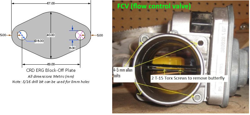

Posts: 7402
Simple, remove the butterfly plate out of the FCV, install a blockoff plate to prevent any further soot ingestion into the intake manifold and then install a FCV/EGR DTC delete tune.
If one is not available, contact Marco, aka Yeti on this forum or over on the Jeep CRD FB forum for a tune to address these items.
Quick and easy! :D
or
Remove the butterfly plate out of the FCV, take the operator for it apart, remove the gears, reinstall it and then install a block off plate on the EGR valve and leave both the FCV & the EGR valve connected. This might satisfy the ECM.
 Post subject: Re: DIY ECU Flash

Yea so i actually did the ERG block off but i did it a little different , where that small Vband is connecting to the intake manifold I used a metal cutting hole saw and made a shoulder on the inside of the vband connection on the intake piece then put some ready gasket silicon on the ledge shoulder and hammered in a 20 cent coin into it ( its not going anywhere) which acts as the blocking plate and cant be sucked into the engine , but it is also invisible to any outside inspection if that ever occurs , it is also easy to reverse or remove if needed, i can add a picture of that if it helps, as its a pretty easy hack that others may like, but what i like about it is unless you pull it apart you would never know its there, unlike other blocking plates that a visual inspection would easily identify.
Yea so i had read about the additional step of removing that plate and i think when i was trying to unscrew the screws which are a torque screw with a center security pin, i stripped the gear ( opps ) in that throttle body, now its just the noise of the thing grinding on the stripped gear that is annoying me when its plugged in :P
I am wondering if there are any vacuum lines connected to that ERG system, will my blocking plate at this location cause any other issues ? , I 100% agree blocking off that ERG system is a great idea stopping soot going back into the intake, i scraped a small bucket of black sticky muck out of the intake while i had it all apart , yuck ! makes you wonder what the point of an air filter when you have this crap going into the engine .
I think i also read that this throttle body is used to help engine shutdown ? but perhaps i am wrong about that does not seem to make any difference when its not connected.
What someone should do is make the connection of this intake pipe to the manifold with a 3inch or 2.5 inch vband so you dont have to spend 4hrs and break your wrist removing the back two bolts to change the number 2 glow plug but thats a topic for another thread :)
So what im really interested in now is understanding more about finding some working map editing software and as one of my jeeps with a 809 ecu map seems to have about 30% more power then the standard ecu map it would be interesting to take a look at what they have done to it, I would like to upload a copy of it for anyone else that wants to use that ecu map as its better then the stock map for sure, but i am not sure how to add a file here , maybe i could send it to yetti on FB and he can add it .
If you make and install the blockoff plate as was pictured/shown previously between the EGR valve and the exhaust feed line to the EGR, it is totally undiscernible to the naked eye. The blank being there can only be determined by disassembly of the connection between the two parts. And the great thing is, you don't have to fool with any of the aggravating v-ban clamps. :-)r
As to removing the butterfly plate out of the FCV, I have done several, and never had a problem stripping the gears in the operator or getting the two small torx screws removed. That should not have happened! But since you did, simply remove the gears out of the operator and you will not have to listen to the noise anymore.
There are NO vacuum lines connected or associated with the EGR system on the 05 & 06 Jeep Liberty CRD's sold in North America. Can't speak as to what components they used in other locations outside North America.
It was said that the FCV was programed to go shut when the engine is shut down, but this function is not missed when the FCV is totally removed. There are hundreds of these vehicles with no FCV and no one has complained of any issues at shut down.
Your best option for tunes is to reach out to Marco, AKA Yeti on this forum, he builds custom tunes for the Jeep CRD. I have been running his Stage IV HOT Tune since 2014 and it ROCKS!!!
