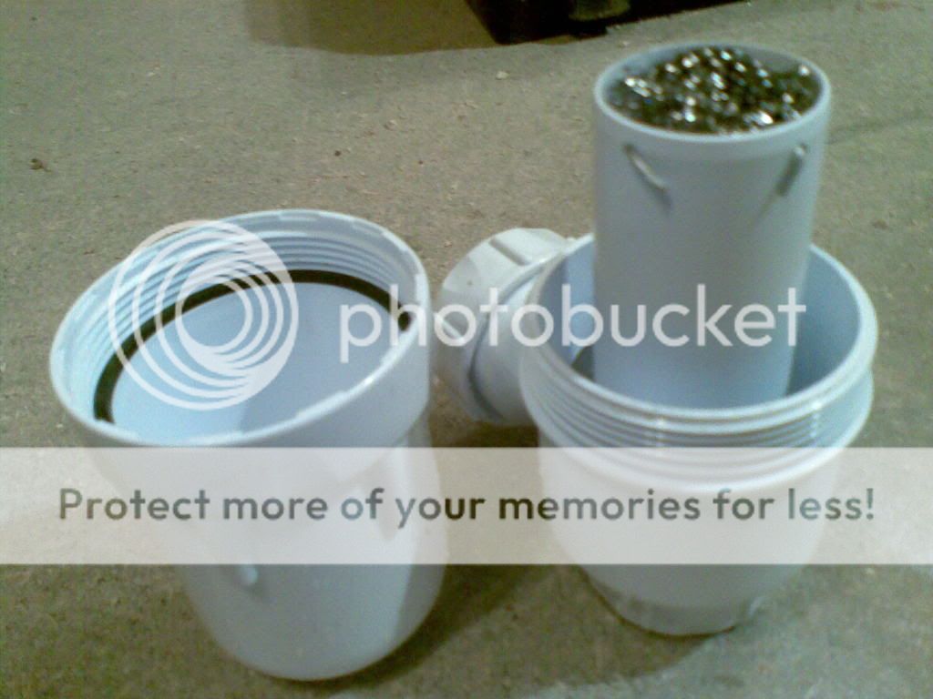

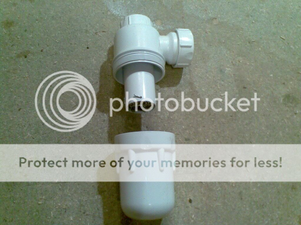

I've done something very similar, but left the end venting to air. Essentially it's an EHM without all the smoke.
I used a compact sink waste trap. The bottom unscrews and I clean the gunk out every oil change.
At first I just used the steel scrubbers
But I found there was still some smoke coming out, so I ended up using some carbon filter material from a cooker extracter fan which I cut up and added to the srubber. It seems to work well enough.
 Post subject: Re: Homemade Provent installed
PostPosted: Sun May 22, 2011 10:26 am
Posts: 977
Location: Victoria, Canada
jnw010
Good idea. Nice clean catch can.
Not all the ehm guys will see it in this thread though.
You should make a mention of it in 'Liberty CRD...Love that Torque'.
The hose connection is compression-fit? Is it 3/4 inch?
You might consider drilling a few holes in the filter tube for pressure bypass if the oil fills up enough to reach the lip.
