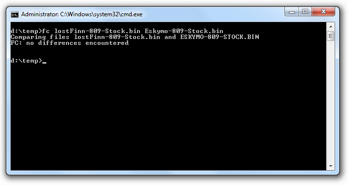

Can you send me your original stock map file for your 809? I want to compare it to Eskymo's 809.

Looks to be the same.
Eskymo, back to basics first, before you spend at lot of money.
Download the 809 from the first post and compare it to yours, just to make sure that you have the original.
In Windows, you can use fc.exe (file compare). It works fine for binary files. You should get the same message as above.
Unplug the Jeep battery for 15 minutes then put it on charge and make sure that your laptop is charged (or plugged in). Shut off all unnecessary running apps (even screen saver, widgets, antivirus). See if you can do an identification and a read. Then try to write the original in medium speed.
Maybe GDE modifies things outside of the 1Meg maps that we write. Maybe you are having a checksum issue.
Try to put back GDE's as well.
