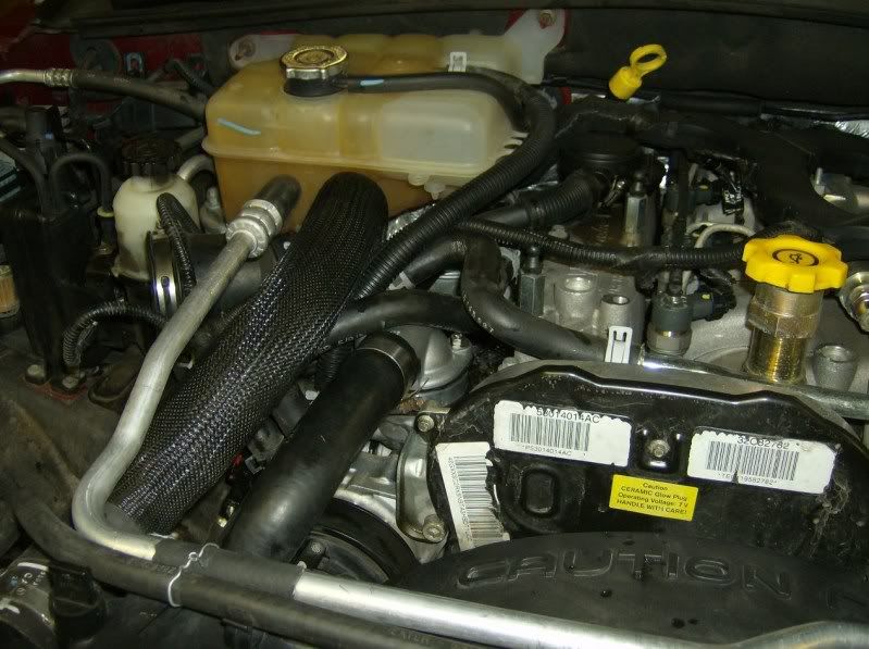

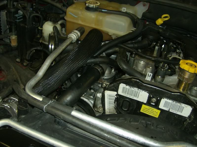

New design with aluminum bypass insert and heavy duty reusable gaskets fully assembled and installed!!!

Temps stayed at marks between top and one left from top even at wide open throttle. Idled at same temp. Looks like around 195*F.
No leaks and great performance. :)
