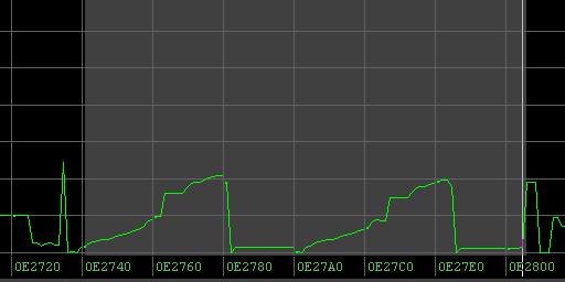

HrastProgrammer wrote:
My original 513 map has to be modified for everything to work correctly?
I just want to disable EGR and FCV, nothing else ...
Your 513 seems different from 526, 808 and 811.
Download the 808 or 812 oem maps from the first page and compare them to Yeti's "ECU/FCV delete - stock" versions of the same number (808 or 812).
The maps have a certain shape to them. They represent a table of data for the ecu to reference.
You will need to find these maps in the 513 bin and modify them like Yeti did for the ECU/FCV delete.
To quickly compare bin files, I use the dos program vbindiff. This gives the hex location of each block of changed data.
I use WinOLS to find the block (table) of data at that hex location.
To get you started, there are 5 maps changed in the 808 ECU/FCV delete. The first is EGR1 at E1E50.
It is a 16x12 matrix table. To disable the EGR, values are changed to 1550 (max).
Watch a few youTube tutorials on WinOLS and this will make a lot more sense.
Titanium may also be able to this.

Thanks for the info. I already compared stock and EGR/FCV-delete 808 files using a plain DOS FC command and visually in WinOLS.
There seems to be 3 ranges of differences:
E1E50..E1FCB FCV?

And two areas from E275E..E2780 and E27C4..E27E7 have to be set to zero - EGR hysteresis, I presume.
I wrote the modified map to my Cherokee at medium speed and did another read/compare afterwards to see if it was flashed correctly.
Then I did an one-hour drive to test it and I really tortured the Jeep after it has warmed up. Everything seems to work as it should - not a hint of black smoke at kickdown on the highway etc.
So, this goal seems to be fulfilled. Here is the modified file in case someone needs it:
http://www.hrastprogrammer.com/jeep/513_EGRFCV.bin
USE AT YOUR OWN RISK! I AM NOT RESPONSIBLE FOR ANYTHING!

Does anyone know the exact meaning of those EGR curves?
I still cannot decipher why are they partially set to zero in the modified 808 maps ...
