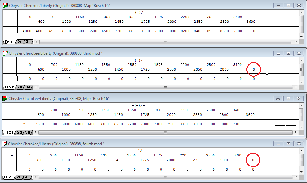

When you get to the egr hysteresis maps, consider changing the zeros to 3600 in the red circles. I believe these are incorrect.
Before and after for 3rd and 4th mod:
