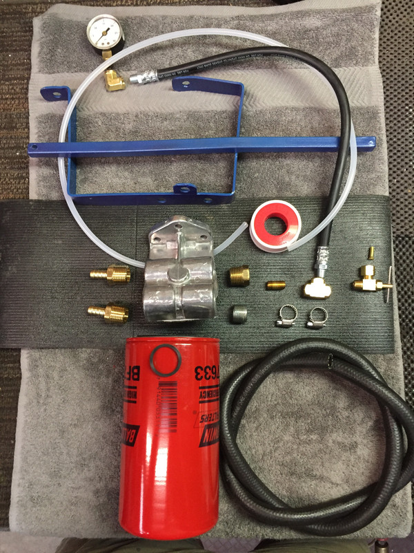

Installed my Carter liftpump and now installed the two Donaldson filters. The primary has the new Racor WIF and is a 10 micron filter with water separator. The secondary is the 2 micron filter.
I made the mounting bracket out of 3/16" stock as per your drawing. All went very smoothly.
I could not have done this without the example, drawings, and explanations of WWDiesel..
https://www.dropbox.com/s/l72nui2w54upmh2/File%20Sep%2020%2C%201%2043%2043%20PM.jpeg?dl=0
Looks Good! Your CP3 and injectors will thank you for doing this!
And thanks for the kudo's, but I cannot take all the credit! Ranger1 informed me of this great mod early on right after I purchased my CRD! I liked it so much, I did the same mod to my Dodge Cummins.... :BANANA:
Every diesel CRD should have a dual filter setup for pump and injector protection! :wink:

A couple weeks ago I installed a secondary filtration setup in my CRD. I used the WIX head and the WIX filter on the WWDiesel custom bracket. Everything is working great! All went as has been noted in past posts, but I will add or reiterate the following from my experience.
I used permatex non-hardening sealant on all of the threaded fittings, being careful to apply none on the first two male threads - especially on the fittings downstream of the secondary filter.
I installed a Facet 40109 under hood with a NAPA 3270 inline prefilter. I mounted the pump directly to the side of the battery using 3M dual lock (think heavy duty Velcro) and wired it to the proper spot on the relay.
I did use the hand pump to initially bleed the air from the system. After the initial manual bleed, I switched over to using the electric pump to bleed air from both the primary and secondary filter heads.
I really thought about using some aluminum stock I had to build a bracket for the head. I ended up using the WWDiesel custom bracket, and I'm glad I did. Nice clean install, and it put things right where they needed to be. No fuss.
Thanks to all previous posters for making this mod go so smoothly!

iakj11, install looks great! Not a big fan of inline pumps since they can still suck air and ingest it into the fuel system from any leak points on suction side plumbing. Like intank pumps better since it puts the entire system under pressure all the way to the CP3. But if it works out OK and you don't have any air in fuel problems, your good to go.
