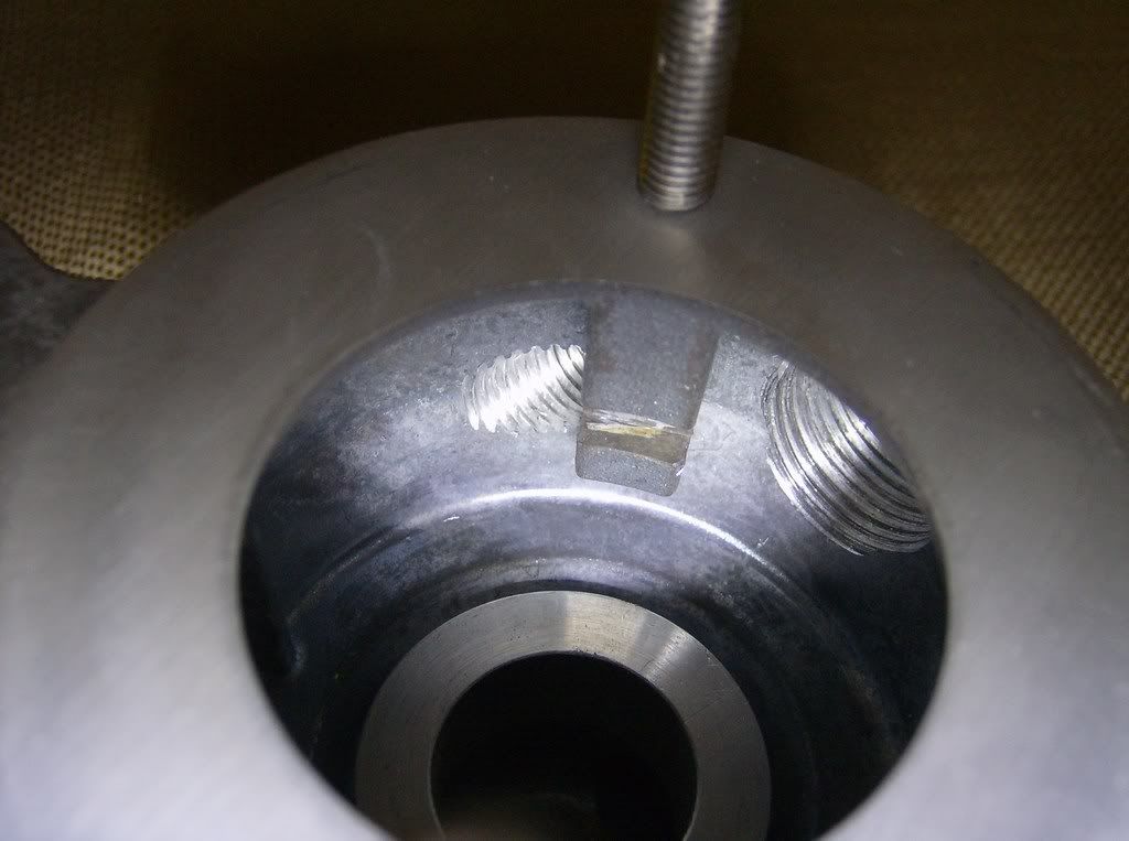

PostPosted: Sun Feb 06, 2011 11:17 pm
Posts: 673
Update -
I have a good method for machining the brass 90 deg elbow now. I used a threaded rod (cut off from a bolt) and machined the tops of the threads down to make it a tight fit for the brass elbow to screw on. Now I can machine either end. I decided to clean up the barbs on the one end to make the hose go on and off easy. It also makes it easy to get the correct diameter to thread the other side of the elbow.
Machining the elbow:
Finished 90 deg brass elbow:
Working on getting stoutdogs unit ready to go out to him w/ the brass fittings. Ran into a small issue w/ the brass fittings since threading the 90 elbow doesn't always stop with it oriented up, there was a little flex with the silicone used to seal it. Despite that, the core has a small crack (not even visible) that would let air out near the 90 elbow piece. I decided to cut threads all the way into the unit and thread the entire end of an elbow to ensure a positive seal. Additionally I used JB Weld on the threads this time to increase structural integrity. This should still be removable since I have removed the studs on an old prototype that were sealed w/ JB Weld with out any issue.
Here you can see the port threaded all the way through now (small port on left is the 90 deg port):
In this photo you can see I nicked the threads in several spots w/ a knife to give the JB weld something to grip on when it is sealed:
Here it is all sealed up with the brass ports and with the 90 deg port threaded fully and the longer reinforced elbow design installed and both ports sealed w/ JB Weld:
I have to go to work in a couple of hours, but Stoutdog's unit should be cured this time tomorrow and ready for a pressure test prior to shipment. I fully expect it to pass the pressure test this time. :)
- Mark

That looks really impressive

Mark, Glad you are recovering quickly..Also, great job on the brass fittings. I am going to limp through the winter with my reduced fuel economy and just install one of your nicely modified thermostats!!
