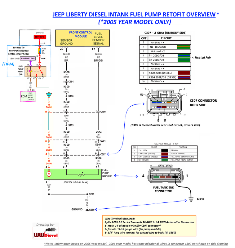

Hopefully this schematic drawing will help anyone planning to add an intank fuel pump to their Jeep CRD and want to add the two additional wires and terminals to their existing harness that are required without having to purchase the complete harness.

Could you repost this image, I am about to do this install and it would be greatly appreciated, thanks!
Images Updated!

Thanks!
Some of us are just catching our CRD's up and the OEM and sasquatch harnesses are not available at the moment.

In addition this helped me troubleshoot my dead fuel gauge, which ended up being a rodent chewed signal wire up near the FCM
