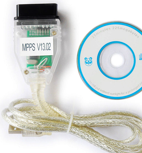

You need this, MPPS V13.02 USB-
I have seen these on ebay for $18.XX US and free shipping.
You may see:
V13
V13.02
V13.02 version 2
V13.02 version 3
but I think that most of the units are exactly the same.
I ordered V13.02 and the cable is labeled V13 only.
The software is V13.02.
Later version V16 (and maybe 18) has been reported to not work. Let me know if you have one working.

I have Windows7-64bit and XP-32bit and with both I had to manually install the drivers for the cable.
-Install MPPS software and run MPPS.exe
(if MPPS asks for version and serial no. you will need to run MPPS by right clicking the icon and choosing "Run as administrator")
-Plug in cable
-Manually install drivers from Windows Device Manager under USB Controllers
>search for the "C:\MPPS\Device Driver" folder for drivers
The software allows you to id your ecu, read and save your current map and write a modified map back to the ecu.
You need to choose:
- for 2005-2007 Liberty/Cherokee = 2.8L CRD Bosch EDC 16CP31 K-Line/CAN
- for 2003 Cherokee = 2.8L CRD Bosch EDC 15C2 K-Line
- for 2002-2004 Grand Cherokee = 2.7L CRD Bosch EDC 15C2 K-Line
MPPS is run with ignition on, engine not running.
Keep the Speed Options to the default Medium.

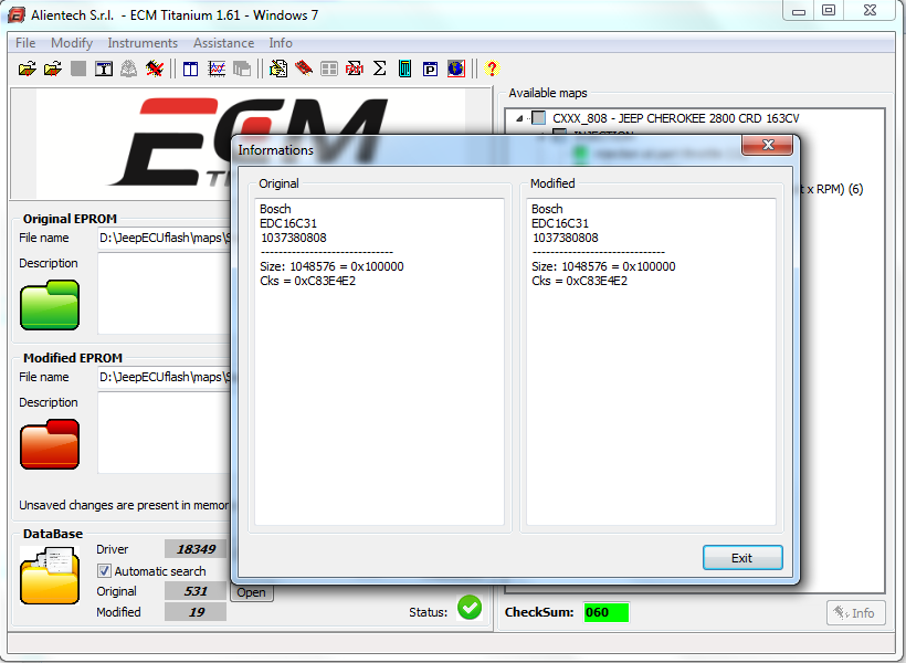

After you "Read F2" in MPPS and save your original map you can look at it in ECM Titanium.
Note that you don't need Titanium. It is only needed to modify tunes if you like.
In Titanium, "Browse" for your map file and it will open this window:
In this case my original map file out of a 2006 American Liberty found the CXXX_808 driver.
Double click the driver.
If you press the "Info" button on the main screen, it shows that my software version is 1037380808.
Notice also that I get a green 060 tag for the CheckSum.
If I then Browse for Yeti's 808 tune under Modified Eprom, I can see what he has modified and that the CheckSum still indicates good:
Using MPPS you can "Write F3" Yeti's tune file into your Jeep.

Let me add a couple of notes to this based on my experience to what Squeeto stated:
You don't have to have these items on AC charge; just make sure your Jeep & Laptop batteries are fully charged before the read and / or upload.
One other important factor Toy shared with me; be sure you have your wireless internet connection disabled during the read and / or Load sessions. Not sure why this is required, but he was adamant that it be done...so I took him at his word :roll:
The MPPS cable off of eBay is what I used to read/load.
I did have some driver issues with the software and ended up having to load the drivers manually on an XP laptop..for whatever reason, they would not load using the setup.exe :banghead:

I run the software on Windows 7, but you need to run it as Administrator (right click on icon) and it works perfectly. Toy is right, shut down Wifi and any other applications that are not needed while loading. The last thing you want is some glitch to happen during the upload!
ALWAYS download and save a copy of your original ECU file first before doing any kind of uploading. Once you have your original safe, then you can start writing to the ECU with new tunes. I can't stress the importance of that enough.

I am not sure can write an edc 16c-c2 , like mine , make sure you have correct the checksum on titanium , if you need a info on the map I am here
ECU Tuner -EGR OFF -DPF OFF Swirl/Flap OFF, Lambda OFF , DTC OFF in many cars , not ONLY
Nick has the MPPS working on a edc 16c-c2 using Titanium driver CXXX_808.
What driver did you use?
Yeti wrote:
I just wanted to point out that the MPPS Driver install issue is not uncommon. I believe it is almost mandatory that you install the driver manually. I had the same issue with Windows 7 64bit.

Yeti wrote:
mine it's 812
so your software is 1037380812?
your ECM Titanium driver is CXXX_812?

yes , my driver is cxxx_812
you have email ,
808 fcv-egr disable
808 fcv-egr disable and tune for you
812 fcv-egr disable
810 missing :dizzy:
i have a
808
809
811
812
original map ,
808 and 811 USA are different in torque on gear ..........i think it's a early f37
809 and 812 are Italian sw 809 for 2005 and 812 for 2007 kj
