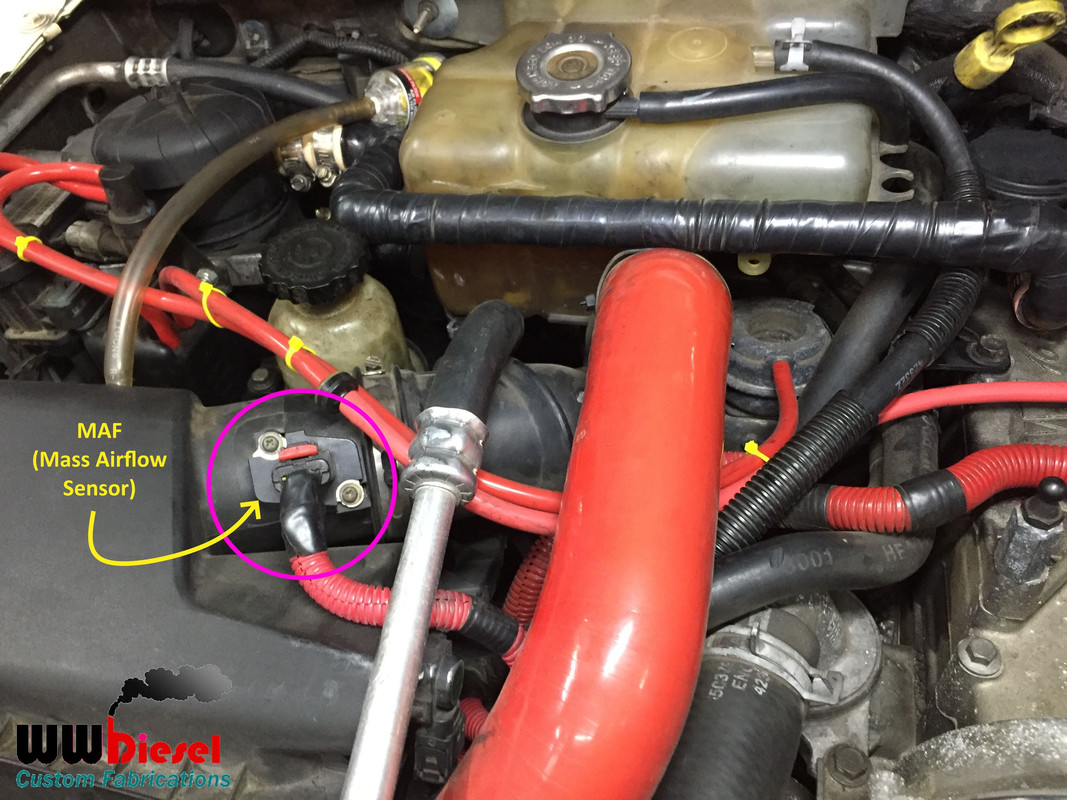

Found the map sensor but cant find the maf sensor and i want to replace it as im getting code P0101

Go to the Section "Liberty CRD Love That Torque"
Right at the top of the page is "SAMS NOOB GUIDE"
There you will see photos of the engine and you will find the MAF sensor there.
You may find that it has been unplugged as I believe this is what owners do to disable the EGR....a software patch can disable this error if the MAF is disconnected but I believe this is no longer possible as it is deemed illegal to disable the EGR!
So if you see this MAF sensor is unplugged..simply plug it in again! My 2002 2.5L Export CRD does not have this setup so I may be at fault here with the above information! :wink:

MAF (Mass Airflow Sensor) is located on top half of air filter housing as shown in this picture:
