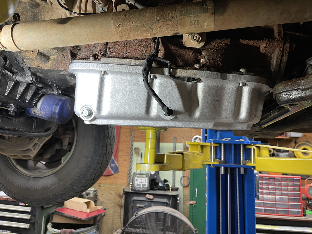

I just installed one of these pans the other day. I've had the trans temp gauge in my A-pillar pod for a while now but kept putting this off. Now getting ready for fishing season I decided to install the pan so Id have a good handle on transmission temperatures as It gets crazy hot here in The Dalles in the summers and I have a 7 mile 2,000' grade to climb with the Libby to get home. Highway driving's not the problem as there's plenty of air passing through the cooler but when you're only doing 20-35 up windy curvy roads in 100+ degree weather that can be a problem. Yesterday I took the boat out and coming back (70F) the trans temp never got over 150 in the pan. Not sure what that correlates to in the transmission but I think having the extra 3 quarts capacity in the pan plus the rapid heat transfer of aluminum will surely make a difference. I have a thermostatically controlled, fanned, tranny cooler that I need to install as well.
You probably won't need it. The PML pan made a huge difference on mine when towing in 100+ degree heat and very high humidity. :D
The pan fluid temperature on mine never gets much above 190 regardless of towing or ambient air conditions. :BANANA:
It was a real game changer! :SOMBRERO:
