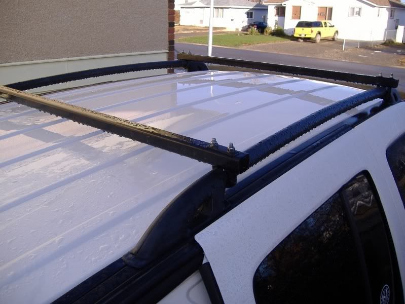

This is a meat and potatoes rack made of 1-1/4" square steel. I plugged the ends with Mahogany and ProBond, to stop the Pan Pipe effect at highway speed. This rack is suitable for lumber, etc. I just u-bolted it to the stock roof rails. Not fancy, but it carries a load securely. :)
