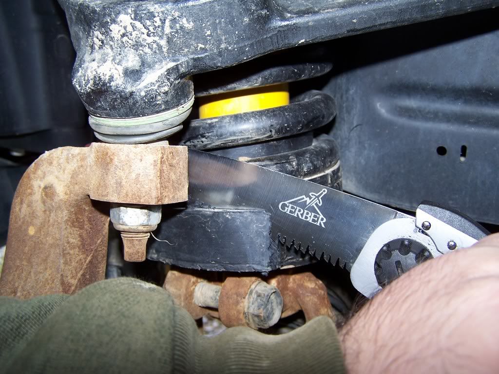

Now that I got to stop by AllJ and pickup these bumpstops, I thought I'd post on how to put them on.
Jack up on the lower control arm to create as much room as possible by the UBJ. Use a short saw (I like this camp saw because it eats stuff in a hurry :) ) to cut a flush edge in the rubber. (*** CUT ON THE SIDE AWAY FROM THE ABS SYSTEM ***(

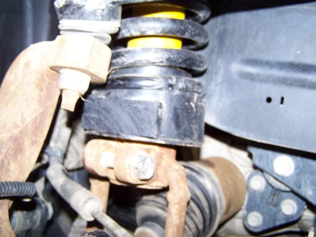

Once you have it flat, use the piece you removed to give you a flat reference plane to hold up the bumpstop while you work the hose clamp.

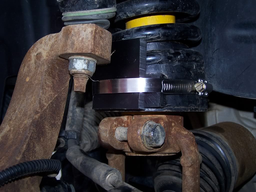

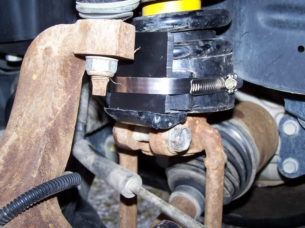

When finished:

Is that suppose to stop any rubbing from a Frankenlift?

It stops the UBJ from impacting on the coil spring, so it reduces any clacking at droop (speed bumps, etc.)

Im sure you read where ed said this moose, but spraying some silicone on that pad will help keep it from turning. :wink:
