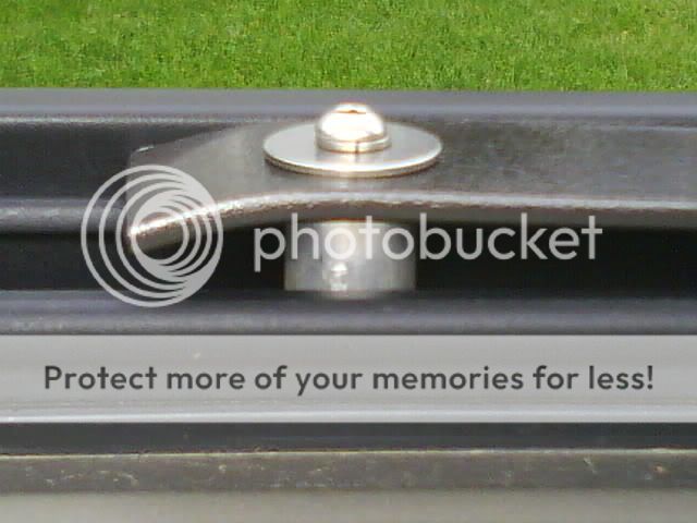

Ok, I have had a couple of requests for more Pics of the rack I made and how it connects to the roof.
So here are some of the details.
You might be able to adapt it to a KK, Or al least get a few ideas! :D

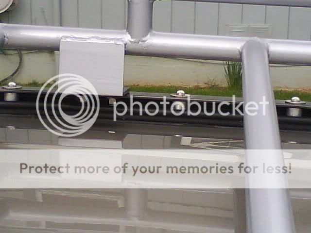

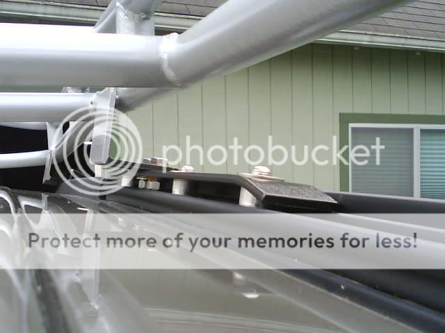

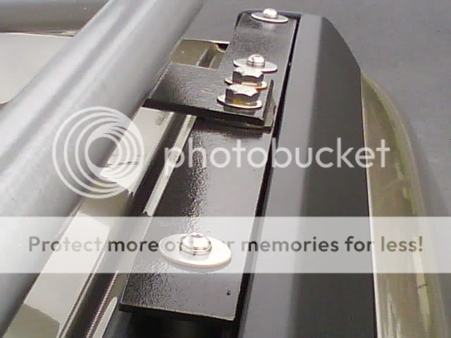

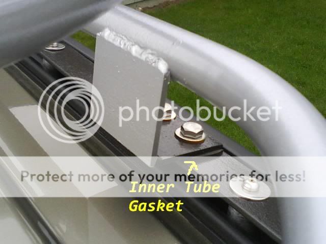

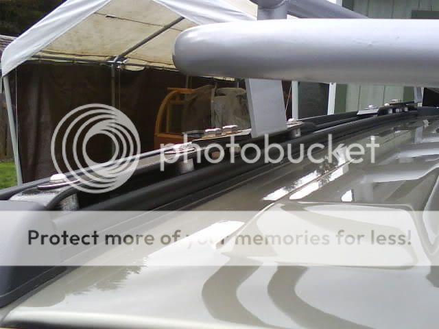

First I removed the cap nuts that hold the Factory rails down. Then I made 1” spacers from ¾” Aluminum bar, Tapped them threw with a 6mm tap.
Then I attached the spacers to the bolts that hold down the factory rails.
(Note, on the front rail bolts, I had to add a washer to hold down the factory rail.)

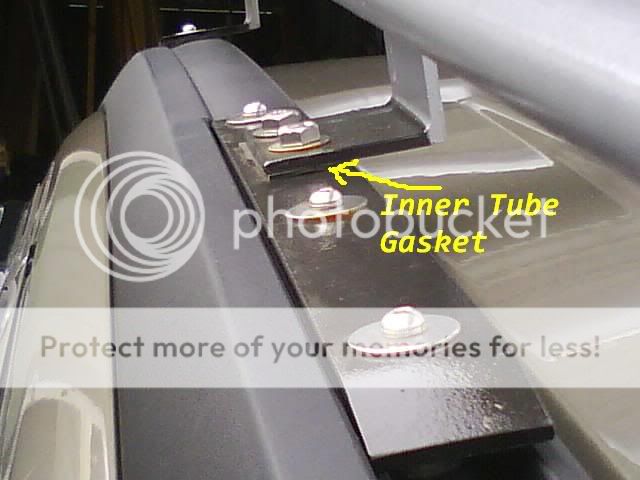

Next, I made flat bars to attach to the spacers.

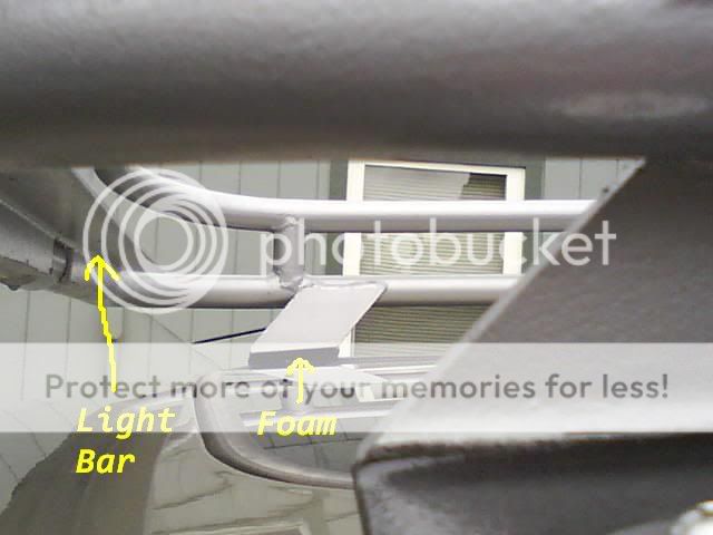

You can see a third spacer on the flat bars near the center. They are just that, a spacer to help distribute the weight. (with a rubber gasket between the spacer and the rail.
I attached the flat bars to the spacers, and then attached the Rack brackets to the flat bars using rubber gaskets made from an old inner tube.

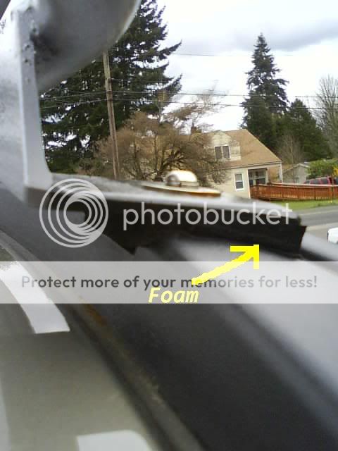

The front rack brackets are connected directly to the spacers, with a piece of foam to cover the hole left by removing the plastic bolt cover.

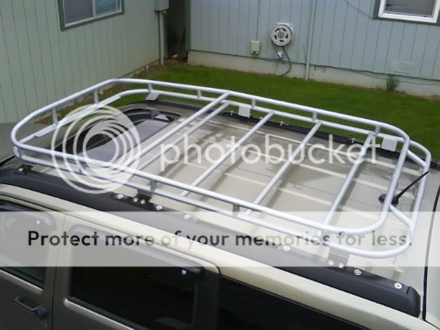

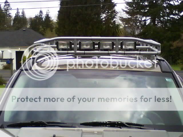

I also put in a top view for the overall design.
The front bar, center bar, and back bar, are parallel for carrying long flat items on top.

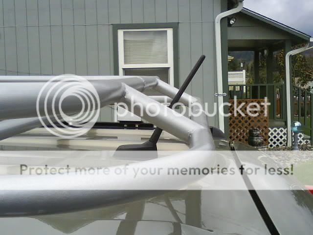

and detail of the antenna placement.

Here is a pic with the lights.

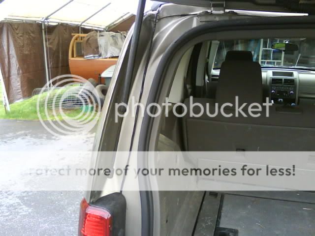

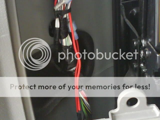

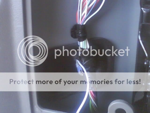

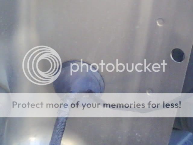

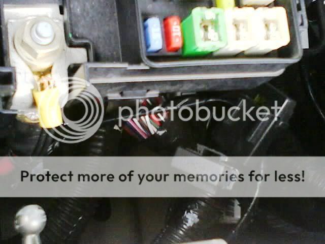

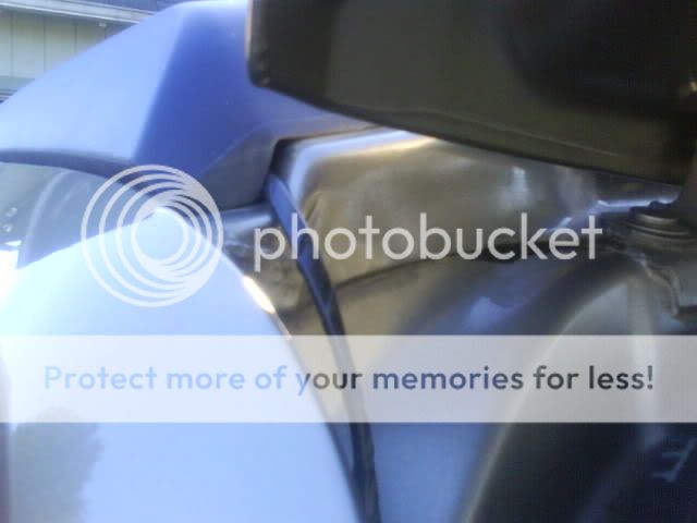

 Post subject: Rack light wire detail.
PostPosted: Sun Apr 05, 2009 7:39 pm
Posts: 1503
Location: S.W Washington
I ran the wires under the light bar.
Through the front hole in the factory rail.
Out the back of the rail.
Down along the hatch and under the tail light.
Through the taillight grommet. Not 1 drop of water has come through.
Through the internal grommet.
Down along the side to the front. Under the kick-plates.
To the switches, located in the storage compartment on the left of the steering wheel. 2 switches, one for the outside and one for the inside lights.
Through the grommet in the fire wall, (where the factory wire harness comes through.) to the Terminal post at the fuse box. With 2 in-line fuses.
