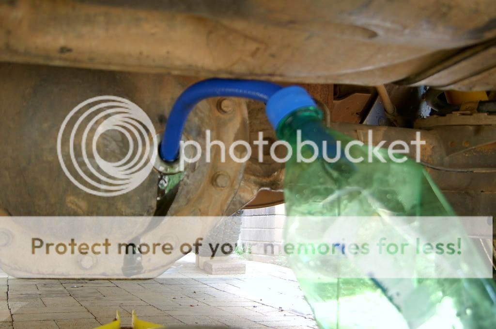

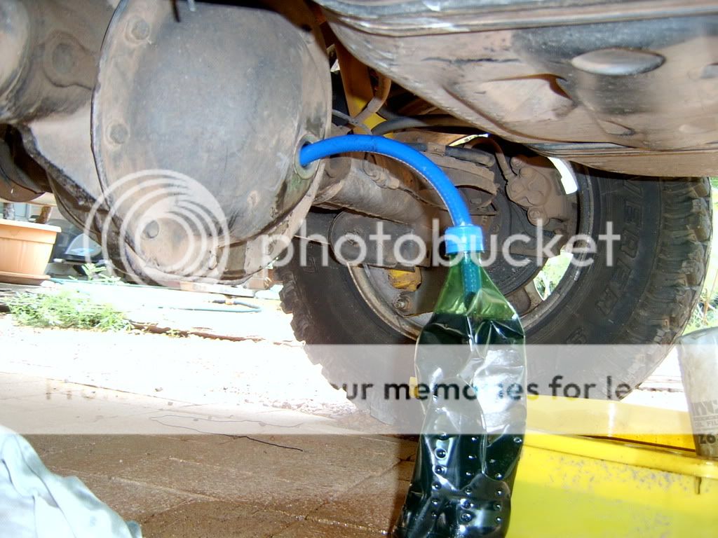

Ok, i posted this on Aus Jeep Off Road forum a while ago. Basically, if you want an easier way to drop your rear diff oil, than undoing the rear housing on the diff, getting oil going everywhere, redoing the selastic gasket, and basically being a PITA, then this is what i do:
Get an 18" length of garden hose (1/2") drill the same size hole in the lid of a plastic Coke bottle (600ml one, don't know fluid onces(?)), Squeeze fit the hose into the lid (needs to be airtight). Insert other end into the diff as shown, making sure the end is at the lowest point in the diff (as shown).
Squeeze the bottle and physics takes over and sucks the oil out!, Do that 3-4 times, you will get 1.8 litres of oil (3 bottles full).
OK, now when every one comments that they like to have a look in the diff and clean the sludge and bits of metal out, thats OK!, this is when you have been crossing rivers on the weekend and just want to change the oil just to be safe, or just because you want to, doing it this quick (takes 15 minutes tops) will mean you will do it more often, i bet. anyway, surprised this hasn't been submitted before(?) :D
Can fill the diff same way as well.
Cheers guys, hopes this helps, now go out and change those oils!
Yeah a Rock Lizard cover has a drain plug, lucky you!
Empty bottle, squeeze, hey presto!
Image[/img]
Full bottle!Image
