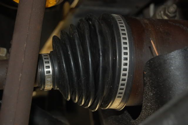

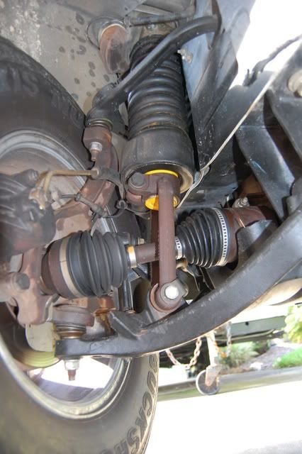

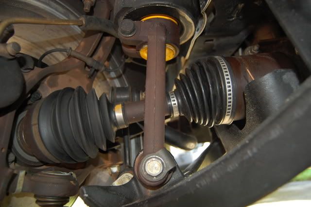

PostPosted: Thu Oct 04, 2007 4:54 am
Joined: Sat Sep 23, 2006 3:34 pm
Posts: 206
Location: Fort Myers, Florida
Jeepjeepster wrote:
Glad you got it figured out. :)
Got any pics of that boot? I wouldnt mind seeing what they look like.
Ask and you shall receive. Made by EMPI, neoprene construction. Seems to be some pretty good stuff.
