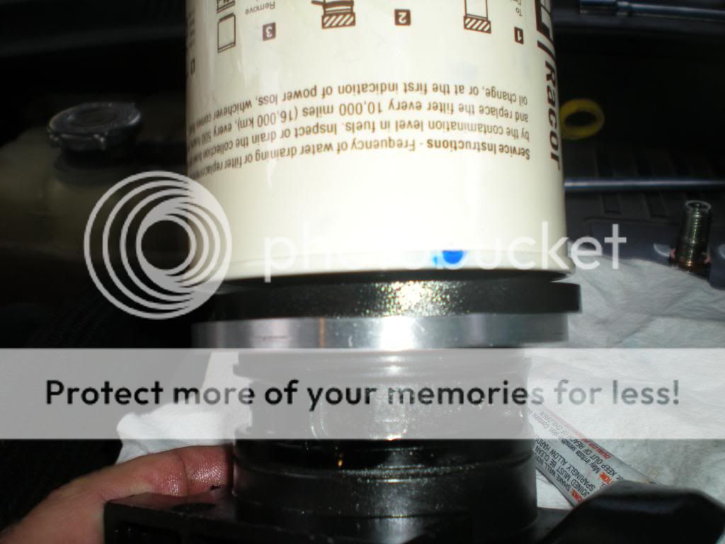

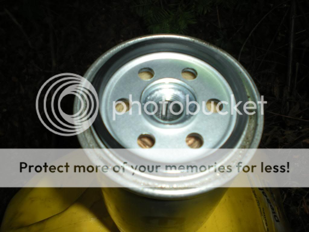

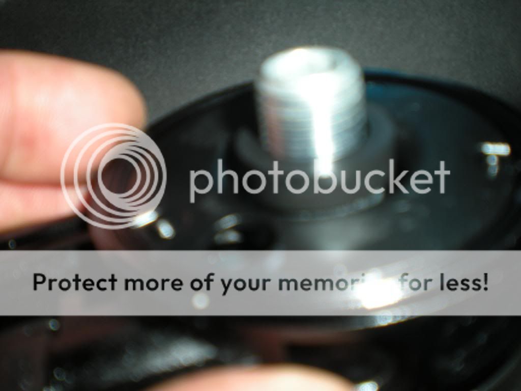

Adapter kit used to install a 2 micron Racor filter onto a Mopar head. The heater, temp sensor, and WIF have all been reused:
WIF adapter:
Old filter:
Kit:
Center O ring:
Adapter plate screwing on:
Adapter plate screwed down:
Loctite on threads to keep thread adapter in place when changing filter elements:
Thread adapter installed:
Threading on Racor Filter element:
Racor Filter screwed unto Mopar head:
WIF and adapter installed:
Mopar filter head with 2 micron Racor filter installed.
Too much work with out CNC equipment, no plans to produce kits for others.

Posts: 68
But why didnt you just put the Cat 1r-0750 filter on? Very easy to make the adaptor.
 Post subject: Re: How to put a 2 micron Racor filter on a Mopar head
PostPosted: Sun Aug 01, 2010 8:54 pm
Posts: 3553
Location: Aurora, IL
There were some problems with the Cat adapter that trashed out some (not all the ones with lift pumps do OK) cashy CP3 pumps. The problem was that you had to unscrew the Mopar center thread adapter and the heater puck would not align properly sometimes and allow air to leak in and trash the CP3 pump. My design you do not take the filter head apart, less chance of leaks. If any one copies my design, I recommend a lift pump. In fact I recommend a lift pump any way.
Personally, I prefer the Racor filter over the Cat, more parts commonality and used in a lot more applications. I can screw on a bigger filter element if I want to in the future, just need to extend the WIF sensor wires. Besides, the Cat does not have the WIF sensor capability.
2006 Pearl Green CRD
Magnaflow 2 1/2" Cat Back
Wife's 99 TDI VW Beetle

warp2diesel wrote:
Adapter kit used to install a 2 micron Racor filter onto a Mopar head. The heater, temp sensor, and WIF have all been reused.......
Yes, the heater, fuel temp sensor and WIF sensor have all been reused.... But, as TonyCRD said - problem is in OEM fuel filter head, not in the filter element.
I used OEM Fuel Filter head assembly for 3 years and aftermarket OEM (Mopar) filter head for 6 monthes - both of them had the same problem (air/fuel leaking).
tonycrd wrote:
Seems a bit pointless to me, the problems with these is the OEM head. Not the filter.
I have 36K miles on my stock Mopar Filter head, get rid of the air suck problem by adding a lift pump, no hot spots and heater burn out problems.
Unplug the heater relay and put it into the console, heater can't fail.
I have done both.
What I don't like about the stock filter is the ~3 micron to ~10 micron rating, 2 micron is much better.
