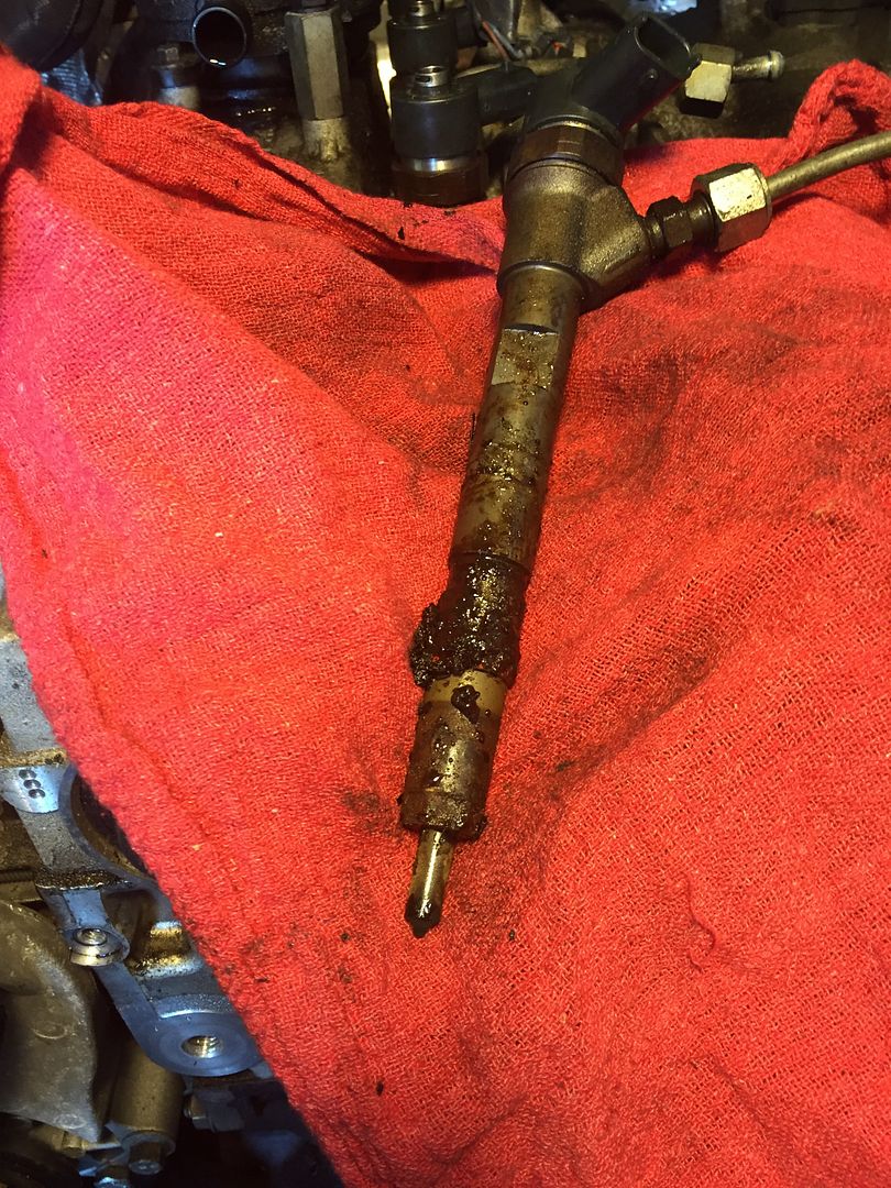

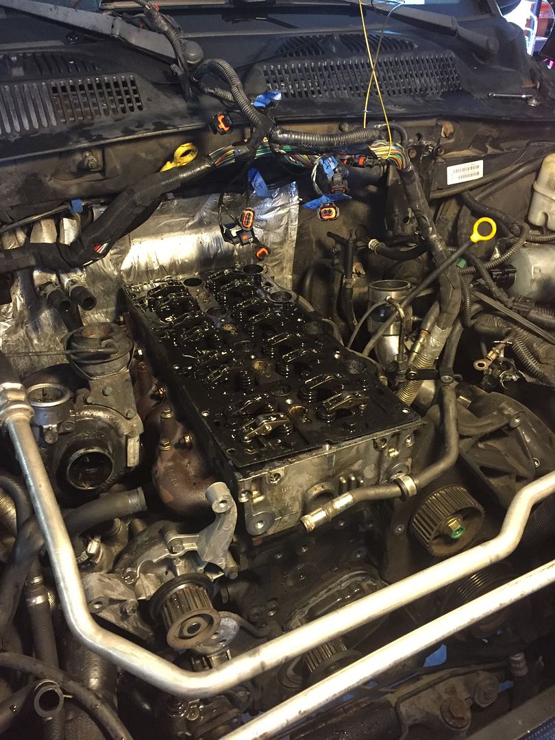

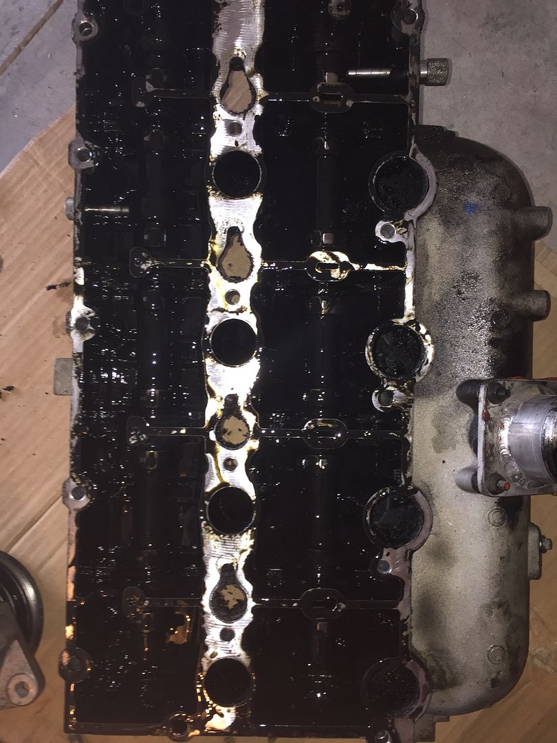

Here are some pics of the process:
Intake manifold:
Can I clean it with diesel and not worry about the cam bearings? Or, do the cams need to be removed? Or, do I need to provide better pictures?
#1 Injector - Look at that crud!
A shot with the head still attached, and the exhaust manifold, and the turbo.... off the HF to "acquire" a shop crane. Just lifting the intake manifold off I disturbed the rockers. I have been wondering how I was going to get it back on without knocking one loose again! Thanks Geordi for the tip!!!
Let my adventure serve as a lesson to the rest of you, unless you are a glutton for punishment like I am, and can afford to have your tractor off the road for as long as it takes, do yourself a favor and "better call Saul" no wait, that's not right. (diesel fumes have me giddy) "Just call Geordi" and have him do it for you!!!
I only have the weekends to work on the truck and the pit in my stomach grows deeper as I watch the collage of engine parts get larger lying on the floor of the garage.
More masochistic pictures to follow.

Here is how I got the head out of the engine bay.
Cylinder #1-#4
Ceramic glow plugs are all intact. And will be in place.
The question I have is, cyl #1 not at TDC as shown in the pictures. Yet, the timing pin is in place in the flywheel.... When this things goes back together, I need proper timing. Where do I go for that?
