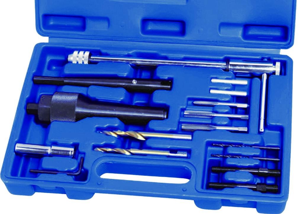

They make a tool kit for removing broken GP's; but if the GP is not accessible you may have to pull the intake to get at it. :roll:
(if you have to pull intake, replace all head bolts with ARP head studs and inspect all rockers for wear and replace any that are worn)
There are also some YouTube videos you can watch on removing broken GP with the tool set.
