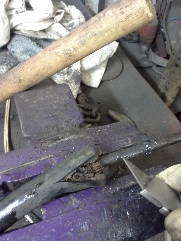

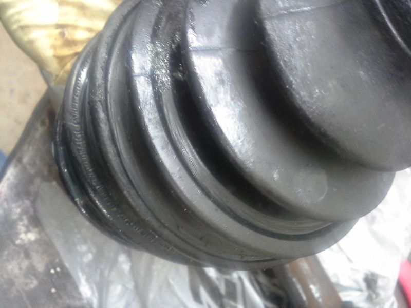

Have spent the last 4 days or so overhauling the front of mine, cleaning everything, replacing this and that. Made sure to take some pics and such to augment the tech section that had some missing photos and such from the tutorials
I started off with the goal of replacing my cv boots, because i let them get something on them, grease, road tar, something, i don't know, and over the course of about 100 miles, it ate grooves into my cv boots before i could take a pan of water and dawn and scrub them down with a rag,
anyway, one had a hole so i replaced all of the boots - which i already magically had in the shed because the time before last, i had bought 4 cv boot kits just to get the boot clamps out of them - it just sucked, i bet i didnt have 12kmi on those cv's
and my LBJ's boots were torn so they were going to ghost pretty soon as well so i replaced those, and cleaned out my jba ucabjs and made some boot spacers because i had never gotten any, so that's taken care of

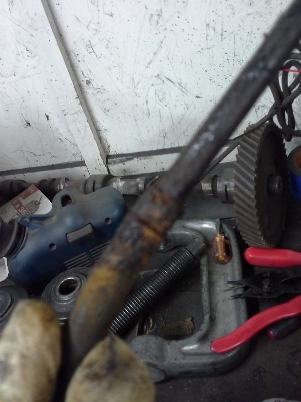

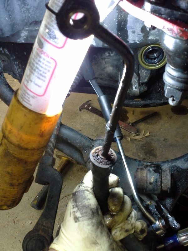

and in the process, i came across this..
out of curiosity i dissected it, the hose wrap basically blew apart as soon as i touched it with the razor knife
the banding on the hose underneath was also starting to rot
so i replaced my front brake lines and caliper bolts, put some new pads on since the frozen caliper bolt on the driverside had eaten up the inner pad - so much for making it to 150k+mi on one set of pads, i was at 120ishK and the front pads were all at 40+% except that one pad lol.. :dead:
and i replaced a TPS that had gone bad, and the front outer bearings and seals
well actually , im still dealing with the passenger side seal.. it decided to not come out with the bearing :roll:
but once i deal with that, ill be putting the passenger side back together having replaced
