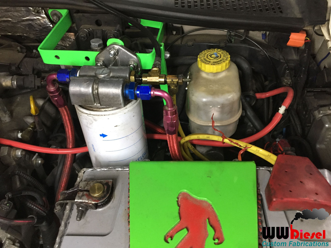

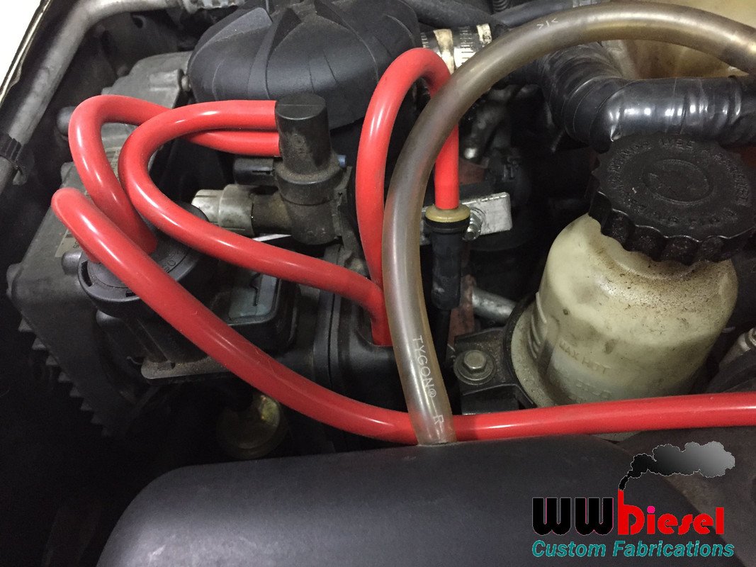

Hey Guys,
It looks like my P0299 code is caused by a broken hose that looks to go from the turbo actuator nipple (thats my name for it), to a vacuum type thing on the passenger side of the engine bay. On the first image I think it is the far left hose (left of the number 1). The hard plastic hose is also pictured in the second image, starts on the exteme left of the image and ends at the extreme bottom. Anyone know of a part number for this hose?

What is the part number for the far left hose attached to element 1 above?

Just order some good silicone vacuum hose and use it to replace all the molded rubber hoses and flimsy plastic tubing.

I actually ordered several different sizes and extra amounts to have in stock for future use. 3.5mm, 4mm, 5mm, & 6mm.
I replaced ALL of the vacuum hoses in the engine compartment from the connection point on the brake booster over to the turbo vane controls and the hose to the HVAC controls.
There are two different size hoses, smaller one on turbo controls and going to vane actuator, and slightly larger ones on supply hoses to turbo vacuum canister and HVAC going into inside of vehicle.
I believe these were the sizes, but would have to go measure to be 100% sure since I had also ordered some 3.5mm hose.
Smaller hose was 4mm (5/32)
Larger one was 5mm (3/16)
Best to measure before ordering to be 100% sure.
Items replaced:
Replaced all of these OEM hoses and tubing with this:
