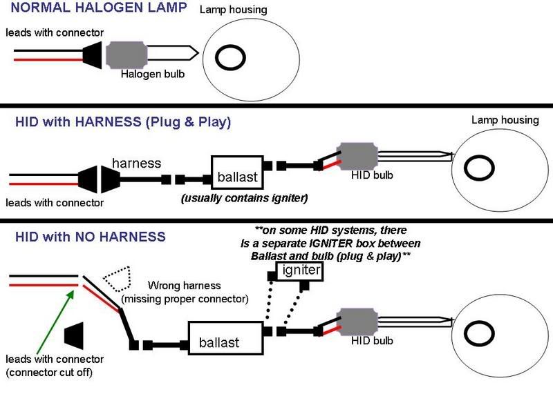

Here's a diagram I drew of connecting an HID system. And following it is a picture of the kit of the same brand as mine (the harness shown in that pic may differ from the actual harness given). I guess the guy I ordered it from included the wrong harness by accident, so it wasn't too much trouble for me to splice wires (my setup is identical to the bottom diagram).
Keep in mind that when you cut the original connector off the main leads for the headlights, if for some reason your HID bulbs burn out prematurely (which is not likely but sometimes can happen) [HID bulbs should last the life of your car], you will have to splice the original connector back to the wires to be able to use the standard 9007 55watt bulbs. HID bulbs have beefy wires extending out the back to connect directly to the ballast or igniter, and will not fit on the 55watt bulb harness.
Oh yes, the actual installation:
1. In my case, I had to cut the harness off the main leads (but if you get the right plug and play harness you wont have to)
2. The ballast mounts to something solid and flat with industrial double sided foam tape (clean the mounting surface with alcohol), or you can always fabricate a bracket (then drilling might be involved)
3. If you get the right bulb size for the KJ (9007 with straight connector), it will fit perfectly in the lamp housing (some people will modify a similar bulb type such as a 9004 by cutting off some of the plastic tabs and fitting that way)
4. You'll have an abundance of wires when finished, so be a good Jeeper and zip-tie the bundles afterward.

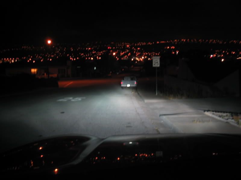

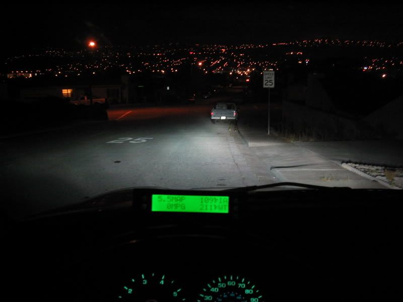

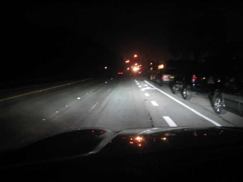

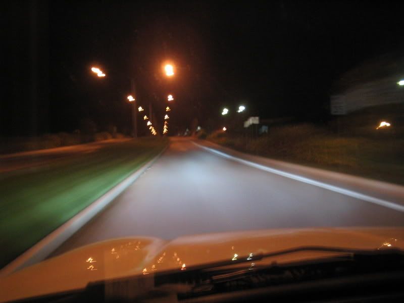

Here's pics of the beam spread. It might look the same as the stock lamps, but I couldnt really show you a side by side comparison because I didnt do a before and after set of pics. The sides are a lot more illuminated, and the front throw is greatly improved. I had to aim the lamps down a bit from the original focus because the light was so intense that it blinded a lot of cars. With this aim, it blinds only slammed honda civics and miatas.

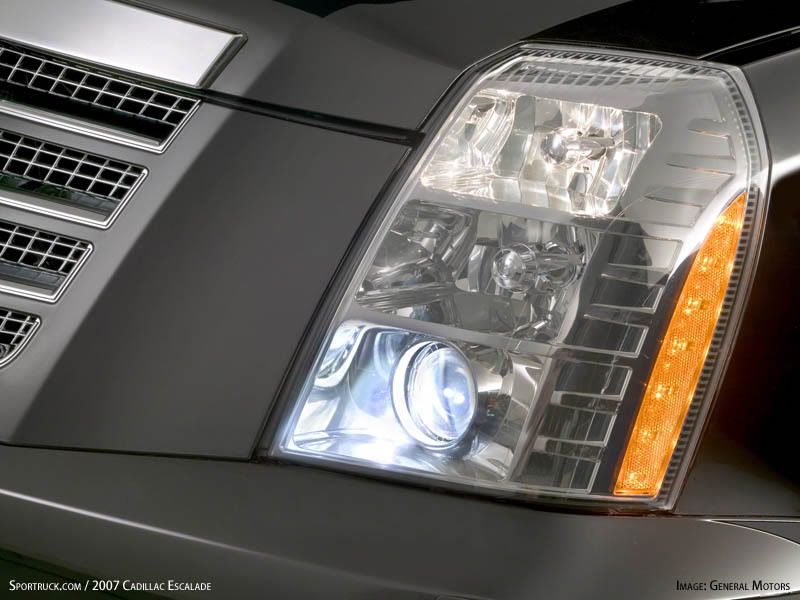

You are referring to "projectors." High-intensity discharge lighting (or HID) refers to the lighting system itself which is comprised of the HID filamentless blub and ballast.
Projectors are a type of housing, usually for HID lighting systems, but in the past have used halogen lights. When HID was first introduced into the mainstream market by Lexus, I believe in about 1994 or so, the lamp housings for it were similar to the standard reflector-behind-bulb style common for halogens, with the exception being a bit more cutoff pattern so that oncoming drivers were not blinded.
As technology got better, someone had the bright idea to use a projector housing (the thick translucent glass dome over the lights). The idea is to imitate the throw of light similar to that of a movie projector, which uses a very sharp rectangular cutoff pattern with almost non-existent scattering of usable light.
To clear up the terminology, I do indeed have HID lighting, but I DO NOT have projector housings which would prevent me from blinding oncoming traffic.
Projectors are the holy grail of lighting technology that most people dream of, but they are very very expensive for a system with good optics. The assortment of projector housings you see on ebay are just bad imitations with little regard for good optics characteristic of projector systems.
And newer projector systems have the dome floating on a gyroscope which senses the angle that the cars nose is pointing relative to perfectly horizontal, and adjusts the lamps to aim higher or lower depending on the circumstance. This allows a uniform distance throw no matter if the car is moving uphill or downhill.
The limitation with projectors however is exactly what makes it great for not blinding people. Just ahead of the very sharp cutoff pattern is extreme darkness. You will have an enormously difficult time seeing just whats five feet ahead of the cutoff pattern. My friend has a Mini Cooper S and a Nissan Murano, and both have HID projectors, and both have this drawback.
With a halogen lamp housing, you can see further ahead with decreasing contrast, but you dont get nearly as much side dispersion as a projector setup. If you look at rally cars and Baja race monsters, they are equipped with non-projector housings to maximize the throw distance, hence why they also use Hella lamps with "pencil beams" (ultra long distance throw). Projector systems are really meant more for high traffic city areas where the annoyance of blinding people or getting blinded is more pervasive.
And besides, theres a glut of Honda Civics in my area with HID that blind even me. Just getting even :twisted:
This is a projector. But projectors ARE NOT synonymous with HID.

Its not good to use the HID replacement bulbs. The reason is becuase the HID is not designed to use in the Halogen reflector and the other reason is on coming drivers see glare from the light going everywhere instead of it being focused as they would be in a projector. The projectors use a very sharp cutoff from the shield built with the projector. The best way, is to buy a set of xenon or bi-xenon projectors from ebay, between 250-650 dollars, and doing a retro-fit. I have done with with my VW Jetta and works very well, plus I retain my high beams. The jetta had a tight fit for the projectors, but from what I see with mine liberty crd, there should be plenty of room. I plan do this with the jeep, just need time, extra set of headlight housings, and some money. When I do get done with my retro, I will post it up. That is going to be a while.
