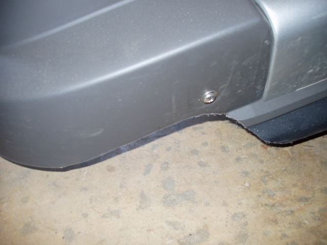

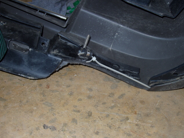

The larger tires will rub in three places in the front: the sway bar, the air dam/front of the wheel well, and the back of the wheel well. To stop the rubbing on the sway bar install some 1.25" wheel spacers (Spidertrax WHS-002). The stop the rubbing on the back of the wheel well, cut off the plastic pinch weld cover, hammer over the pinch weld, and then cover all of the bare metal with undercoating. To stop the rubbing on the front of the wheel well you'll need to devise some way to pull the front of the well forward into the front bumper. You'll also need to trim out some of the air dam where it rubs. This is all possible and still looks completely stock. You should only get slight rub when the wheels are turned to the extremes while going in reverse. As for the back tires, they fit fine, although they do stuff off road, not that it hurts anything other than flexing the flares. You'll probably also want to put the spacers on the rear wheels as well for symmetry (probably other reasons as well). The spacers are just the right size for my Renegade that the wheels don't project past the flares, so they don't throw road crap up on the car. I love these tires and they got me through the muck when MTRs were getting stuck ;)

I've removed the front inner splash guard, removed the pinchweld completely and the sway bar isnt even on when i'm wheeling so I guess that should be good, Its more the rear i'm woried about. My guards that are attached to the rear door haven been popped off permanently down the bottom and I dremelled out the plastic from the upper section of the wheel arch so the 245's didnt rub, also bashed the crap out of the steel section to lip it up (much like guard rolling for 20" wheels on lowered sports cars :) !
I should take some pics & post, but the weird thing is, that ABOVE the pinch weld section on the front, it rubs bad there? and i've bashed it back a alittle ?

To hold the front of the wheel well inserts into the bumper I used a tie wrap looped through a cable clamp that I bolted onto one of the original rivet holes:
For the front right side I also heated up the wheel well plastic with a blow torch and bent it forward around the washer bottle. With 265/75R16s the tire still rubs at the washer bottle, but not enough to bother doing anything about it.
