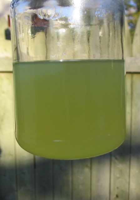

20 years of owning a diesel vehicle and I just got my first load of bad fuel. The thing could barely get up to 50MPH, no codes. I pulled a sample off the air bleed and the fuel is yellow and cloudy. Smells like wax. You would think with the introduction of ULSD that fuel from a reputable station would only get better. Be careful out there.
Now, considering that it is a holiday weekend and the dealer is closed, I could use some guidance for dealing with this. As quickly as possible.
The station was Shell 1449 Battlefield Blvd, Tidewater members take note. I've notice the fuel at all the local stations lately has been extra foamy and funky smelling.

Siphoning fuel out of your tank is stinky business,but easily done with cheap plastic hose from Home depot or wherever. But that won't solve the most pressing problems.
The larger problems from "bad diesel" could be
1) junk from fuel now in your tank, possibly sediment dirt
2) algae bloom (which is probably clogging filters)
I suspect a bloom is the problem. Can't be easily fixed at home, take to dealer. There ARE commercial additives called biocides that kill diesel algaes but it won't solve all the problems, so let the deal tow and handle it. Don't chance it.
If you are really curious, the water-seperator should drain out some glop if you open it.

How did you take that sample, thats awesome. Is there an easy access to the fuel line or something?
On the side of the fuel filter housing is a nipple for bleeding air from the system when you change filters. I put a piece of tubing on the nipple, ran it into the jar and cracked it open as if I was bleeding air. You have to pump the plunger a few times to build up pressure so the fuel will come out.

Is that the same place where you're supposed to push/pump something after you ran out of diesel? How does that work.
edit:
There is a nipple on that pic, but how do you get diesel out of it? :D

See the silver fitting hiding behind the gold colored side banjo fitting? That is the bleeder screw. Just like on brakes but bigger. Simplified procedure goes like this: Push on the plunger up to 20 times or until it is harder to push. Open the bleeder. If there is air in the system, you will hear it hiss. Repeat until fuel comes out. There is no need to push on the plunger while the bleeder is open like when bleeding brakes. I don't know how, but it doesn't let air back in.

I can think of 2 possibilities here - one is that the fuel tank and system cleaning, and new fuel will take care of the problem - the other is more serious, depending on what's actually in that fuel, damage to the CP3 pump and injectors may have occured. In either case, I would have a good Jeep/Dodge dealer with diesel mechanics do the repair, as you will need very good documentation from them if the pump and or injectors are damaged. Chances are that they're fine, but I would proceed as if they were negatively affected and have it thoroughly checked out and fully documented on your service record.
Suggestions on the vehicle:
Have it towed (don't run the engine) to a dealer and ask them to:
Drain and clean the fuel tank and lines
Replace the fuel filter, and keep a spare filter on board the vehicle just in case
Drain and purge the fuel rail, injector lines and return lines with a good diesel purge product
Add diesel fuel conditioner to the tank
Check the injectors for proper flow rate with their scantool diagnostic and other checks designated by the FSM
Check the fuel rail pressure readings to be sure the CP3 pump hasn't been damaged by that nasty looking fuel
If it isn't running correctly after that, have the injectors removed and tested.
Keep a sample of that fuel and receipt for proof of payment
Document all of the charges and present them to Shell as quickly as you can - it could be several hundred dollars or more if they have to remove the injectors and test them as well as clean the fuel tank. If the pump or injectors are damaged, replacement cost could be in the thousands
If any fuel pressure readings or injectors are off spec, ask Shell to pay for replacing the pump and injectors if necessary. You will probably need excellent documentation from the dealership showing off spec readings on the fuel pump and or injectors before this would be necessary or approved by Shell. It's critical to keep a sample of that fuel for lab analysis if Shell asks for proof before paying for anything more than fuel tank cleaning and replacement.
Let us know how it works out. There is at least one member here who had a bad fuel experience - iirc, his was a case of cleaning, not equipment replacement. Wouldn't hurt to ask him if I could remember who it was :-) Don't remember if it was OldNavy or not.

That was me about 9 mos ago. Mine died on the interstate while passing a semi. I called and left messages on the gas station's machine to document that it had happened that night, and had it towed to the dealer, writing on the tag that I suspected bad fuel. They had to drop the tank and clean it out, replace the fuel filter and flush the lines, to the tune of $800. I had them save a sample for me, but you've already got that. I took the sample, fuel receipt, towing and service receipts to them and they cut me a check. It's been running fine ever since. This was B20 BTW.

Couldn't do anything on it this weekend. The tow truck picked it up this morning. Hooked up my code scanner this morning and pulled P0093. That equals Fuel Sys Leak Detected-Large Leak. Didn't smell any fuel leaks. No CEL???
I am trying a different dealer than the one I bought the Jeep from. It is going to a dealer that also sells Dodge trucks. I noticed a lot of Rams parked in the employee lot so hopefully someone there speaks diesel.

Just as an FYI, the CP3, rail, and injectors are all internally coated with a wear package from Bosch for situations just as this. I have seen fuel that was literally gel go through the system with no noticable effects, so there shouldn't be a need to worry about damage to the components. Drain the tank, change the fuel filter and you'll be good to go.

Good to know. The only thing I fear is that the fuel was contaminated with something that eats up parts.

The delay in fixing mine looks like a case of the Bigger Better Deal. 3 Dodge trucks came in the same day with blown engines from water ingestion. My Jeep would have been a cash cow on any other week but $5000 Cummins engine trumps $500 flush out every time.
They have done some work on it and actually hooked it up to the StarScan and determined that it has a bad air leak in the fuel system. That is a lot more than Greenbrier ever did.
I had to deal with the Manager because the Service writer was out sick for a few days. The Service Manager tried to BS me with the "Parts are on Order" line. I asked him "what parts?" He said "parts". I said "exactly what parts" He didn't have an answer. I told him that he was feeding me a line of crap and if he had parts on order the exact parts would be noted on the invoice. He realized he was busted so he went to talk to the mechanic and came back with the correct answer, "We haven't done anything on it other than check and confirm the fuel is bad. There are 3 trucks ahead of you with blown engines, the mechanic is working on those first."
The Writer was back at work and I had a long conversation with him. I think we are on the same page now. If I tell him the engines makes too much exhaust smoke he knows that I know what is normal and what is too much. I don't expect to be told again that all diesels smoke and rattle as Greenbrier told me.
