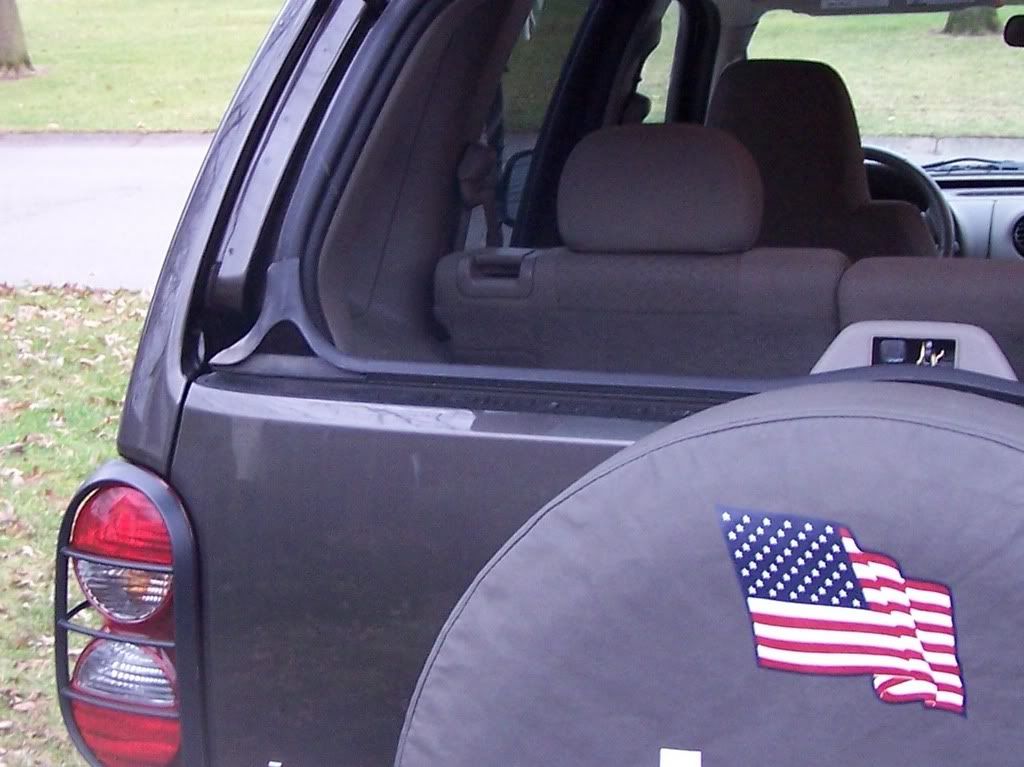

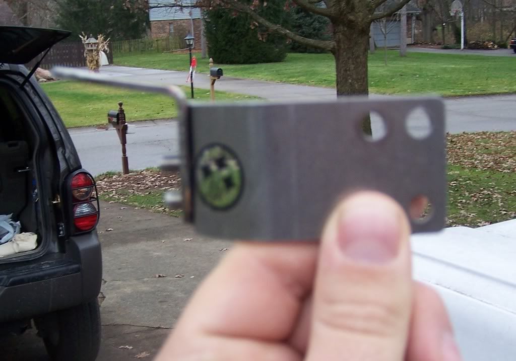

OK, I just got my birthday present box from Walcott CB from Iowa (http://www.walcottcb.com) and got it hooked up. I went with their MK204R (http://www.walcottcb.com/firestik-mk204r-door-jamb-mini-kit-p-576.html kit to install where the rear window and door meet:

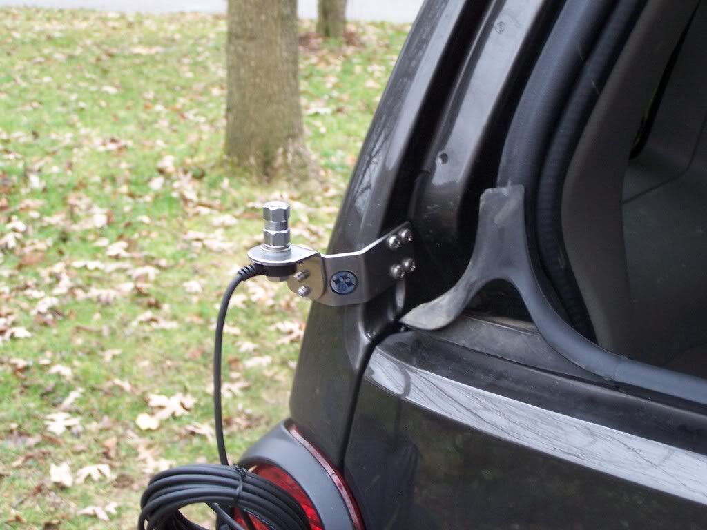

I placed the bracket in there to find the flattest location. I then drilled the upper left hole (1/8" bit) and installed the mounting screw. This allowed me to determine how much upward bend I had to put on the L
bracket.

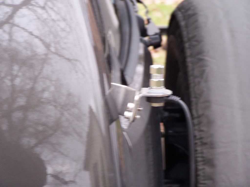

I then reattached to mount with the single screw and drilled the rest of the holes. I would recommend drilling the upper right hole next, and installing that screw before doing the lower screws.
Next I attached the coax (already in the pictures above) and ran it down the door hinge and over to a breach in the rain seal.
Once through the seal, it is a simple matter to stuff the coax under the plastic molding and proceed up

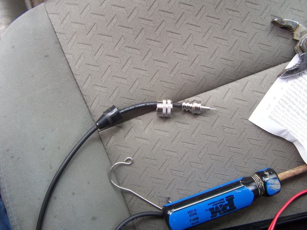

the drivers side of the Jeep. Although not pictured, I used the kickplate molding to get through the back seat, and the door pillar molding to get to the front of the front seat. The 18' of cable they send is fine for a dash mount, but a 20' would be necessary to mount up above the rear view mirror. A picture is provided of the coax assembly - this seemed to be the hardest part of the entire installation, however the picture should help ease your pain. EDIT: I have now soldered the center wire into the housing, and it made all the difference. I strongly suggest 30 seconds with a soldering gun on this effort

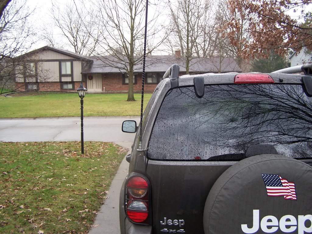

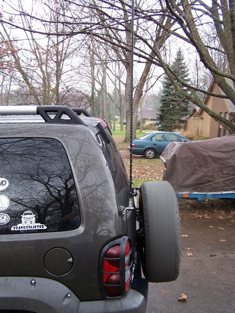

Finally, I attached the 4 foot firestick II onto the mount. Now, for tuning and use!

What thicknes stock is that? My school has a bunch of scrap in our machine shop i frequent and I could probably fab one or some of those up quick, I need one anyway since I have a Firestik as well. Now i just need a CB and coax cable. Which Cobra you got Moose and do you really think you might sell it? I've been looking at the Cobra 75WX and the Cobra 19DX, just not sure which would be better, I know the 19 is cheaper but would it be worth it to get the 75? Any thoughts anyone on that?

moose, i got the same firestick mount, but put it between the left tail light assy, and the body.....in front of the light....it's more off to the side of the vehicle, obviously, but it will never interfere with the rear glass.

Post a picture, I'd love to see it. BTW, I don't have any interference with my mount either.

By the way I did fab up my mount today, i'll get pics of it tomorrow, I still need to get the holes drilled in it and also the screws for it. How did your screws stay mounted to the Jeep...not really a way to get a nut on the back end of those screws...did you use some locktite on them??? some details would be great on that as i'm just wingin' it. Plus did you add any coatings to help prevent from rust since the holes are located in a water channelling area??? Thanks again moose...
locktite? anti-rust? guess I was winging it too :)
