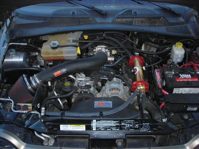

JJ, whats that copper colored cylinder with the red ends between your battery and alternator? It looks aftermarket of course, but what is it?

That is the harmonic trifibulator. Gets me an extra 150 HP and 25 MPG uphill w/ a headwind. Yeah I know, :roll:
But seriously, it is an on-board hot water shower system. That cylinder is the heat exchanger assy.

you can make a hot water shower assembly like that alot cheaper than buying the kit, my dad and I put one on his CJ 5 just have to buy the copper and adapters
Lemme get this straight. So that thingy allows you to input a hose running cold water while you have the engine on to warm it up inside that cylinder so you can output the water to a shower for when you go on the trail?? Or is it like a hot water windshield wiper spray?

streetKJ wrote:
I'm really noob at this offroad stuff, but you guys seem like you have some cool toys.
Yes, a hot water shower for taking showers on the trail when wheeling. It uses an RV style pump system to pressurize the water.

JJ, What are those two cylinders in front of the air filter
