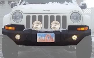

[NOTE: I don't make or sell these bumpers--JHCRASH (Jason) does. If you have any questions, please look at the first post in the original thread here, then PM Jason.]
If this is the first time you've seen this thread, here are some background details:
JHCRASH (Jason) announced on November 26, 2007, that he would be making a new front bumper for '05-'07 model KJs, and he posted some pictures of a completed bumper.
A few posts later, he mentioned that he needed a "guinea pig" to fit an older ('02-'04) model KJ, and I volunteered. (Yeah, twist my arm!)
This thread was created to show off Jason's bumper design and allow open discussion.
See Sundance Customs Offroad Website for more pics and ordering information.
Details
Price: $900. $650 introductory price until February 1, 2008.
Lights not included. Your actual price may be higher or lower, depending on options that you choose. For example, the price will be lower if you don't want the stinger.
Add $75 for paint. Powder coating may also be available (price TBD).
Weight as pictured below ('05-'07 model with stinger): 120 lbs.
The '02-'04 model will be about the same, but you may save 5-10 pounds without the stinger.
Highlights:
  • No washer bottle relocation required. This bumper actually protects the washer bottle. (Some ground clearance may be lost compared to other bumpers that require washer bottle relocation.)
  • Use stock turn signals.
  • Integrated fog/driving light mounts. They protect your lights and look really cool.
  • Stinger can have light tabs, too.
  • Fabricated mostly of 3/16" steel (some 1/8" in accents) - VERY strong.
  • Jason will provide 3-ton shackles that look like 2-ton shackles--not bulky like the cheaper 3-ton shackles.

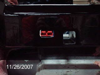

  • Wicked cool power plug for winch, jumper cables, or whatever:
Some things to keep in mind:
  • As mentioned above, it is likely that some other aftermarket bumpers (ARB, RL) will give you a better approach angle. We don't know for sure, though, and we won't until we can put the bumpers side by side and compare (which we'll do in Moab in a few months :D.)
  • Like any aftermarket bumper for '02-'04 model KJs, you'll have to cut your fenders. A lot. And it's a PITA. However, for you lucky '05-'07 owners, Jason has configured the bumper so that no cutting is required.
I can attest from personal experience that Jason does great work, and I think he's going to run a very honest, responsive business.

Here are a couple more I took with my crappy phone camera on Saturday. If we get it installed this weekend, I'll take some good pictures with a real camera.

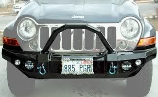

Here's JHCRASH's original post with pricing and a few of the pics of the '05-07 model bumper, for reference:
JHCRASH wrote:
Well its finally available,We are going to offer this bumper to the members of lost and maybe another forum for $650 until febuary 1st. It will then go up to $1000 so now is the time to buy guys.For that price the bumper will be raw if you want it painted it will be an additional $75 and i dont know a price on powder coat yet.WE are a custom shop so we will offer a few different options on this bumper for a lesser price just email us to discuss it. sundancecustoms@yahoo.com
The weight as it is in the pics is 120Lbs.
We also have our own version of sliders and a rear bumper coming soon.
Here are the pics.Sorry so blurry.
This one is with the logo as a marker light
This is a plug for the hitch when it is mounted in the reciever or we will offer jumper cables that plug into it as well
This one just has an odd light on the stinger for illustration the other set of 510s wont be in till tomorrow
These pics show the quality and finish that Jason puts into these bumpers. Hopefully we'll get mine installed this weekend and I can post completed shots.
