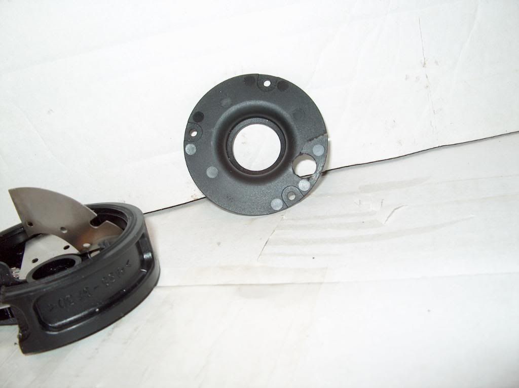

Wanna talk aboutcher pucked up!!!
Any questions?
Exorcised puck...........
Numismatism, anyone...........
And........
And, also.........
Bad conductor Karma, here, folks..........
Furthermore..........
Etc..........
Etc, etc.........
Notwithstanding...........
Finis..........

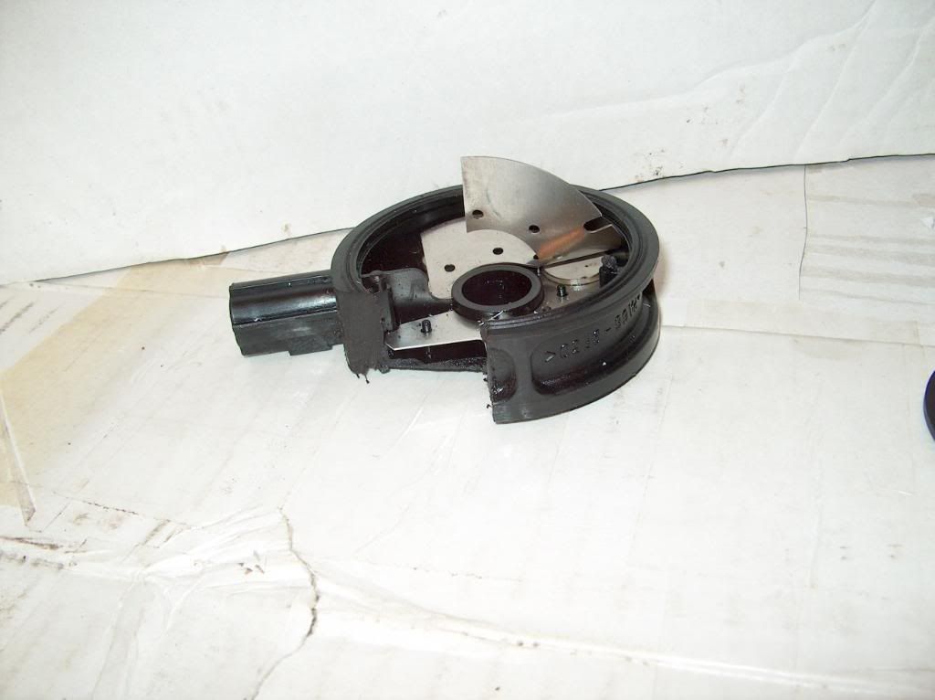

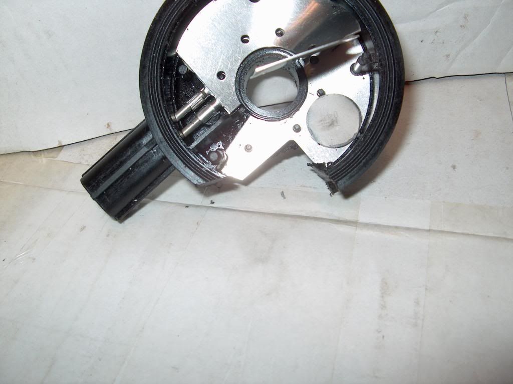

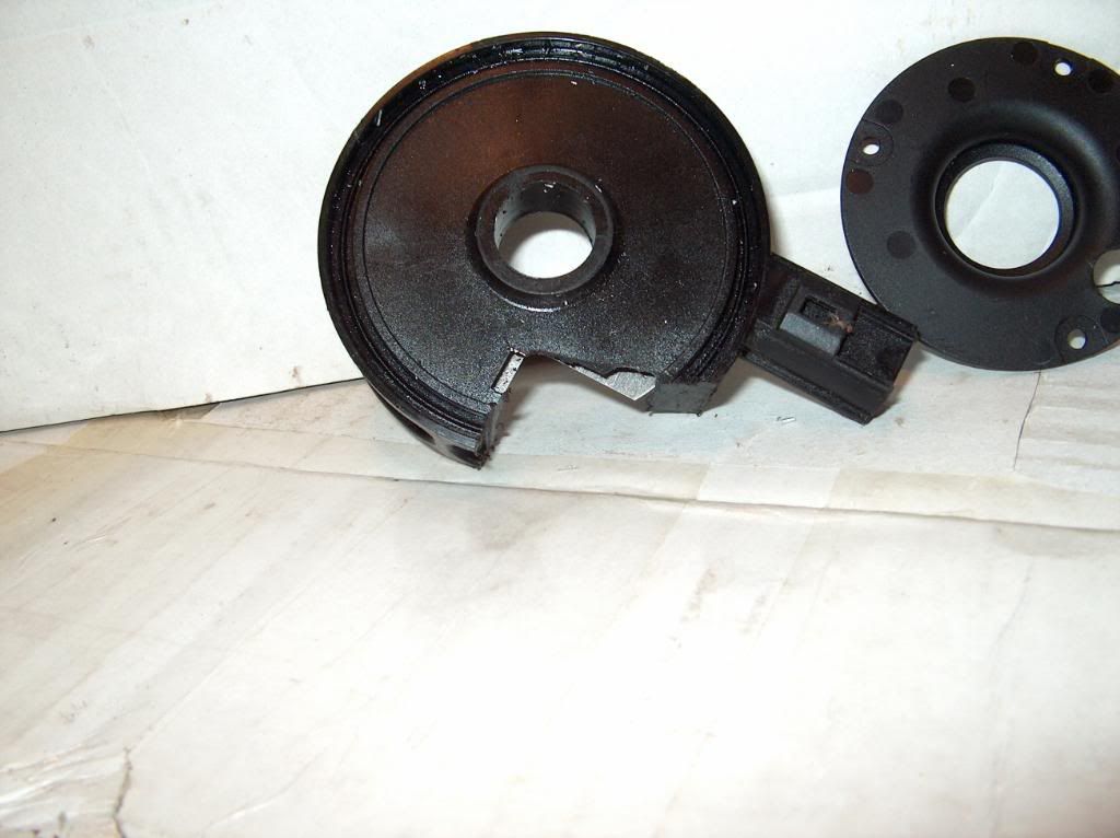

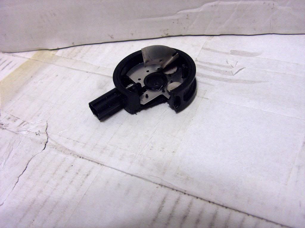

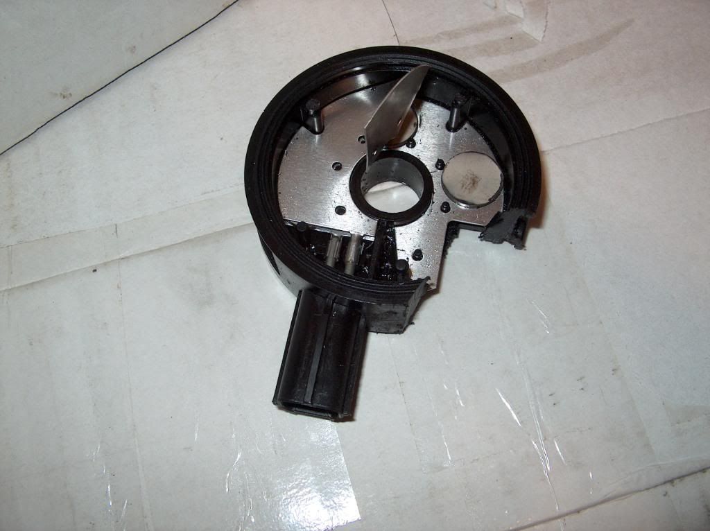

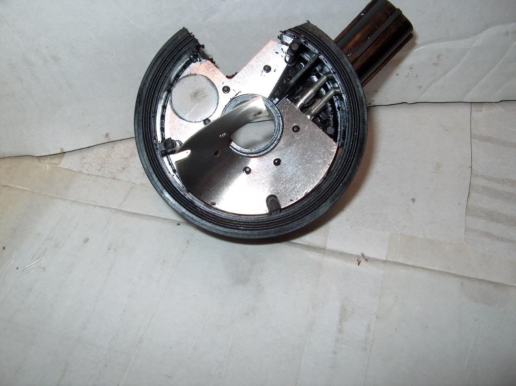

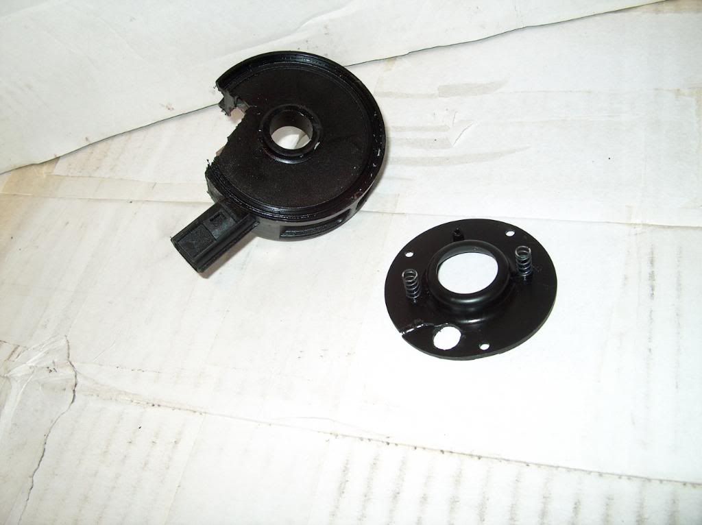

For those who're interested, this is a solid-state heater puck, using those same variable resistor Varistor devices used in yer TV to limit current, but with a reverse temperature coefficient: when they're cold they draw enuff current to get warm - when they're warm at a certain temp, in this case 85degF, they taper current off, drawing just enuff current to maintain 85deg
That's yer Varistor, that small round coin on the aluminum conductor\sink, another one visible just around the corner, there, between the sheets (sorry, no porn here, folks)- the upper sheet is power, the lower is ground - those springs on the plastic cover, of which there were three (one currently resides snugly in the KJ engine bay, somewhere), one for each varistor, compress the varistors between the sheets for max current when cold, reducing tension as they warm up, further reducing current thru the varistors - it's pfm, folks - pfm

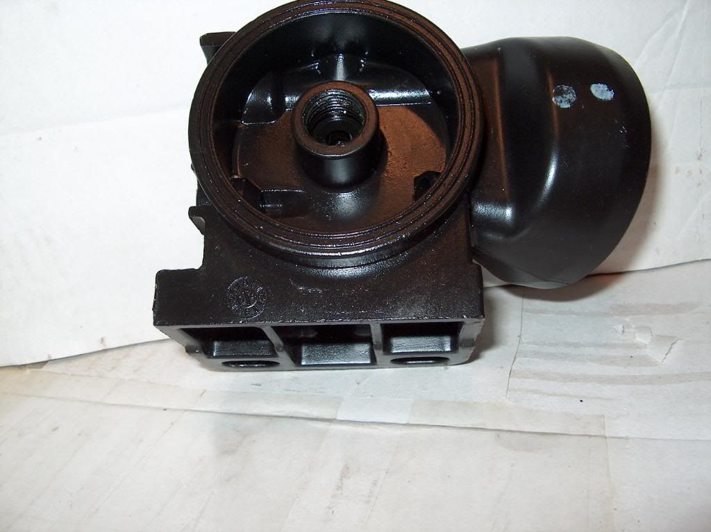

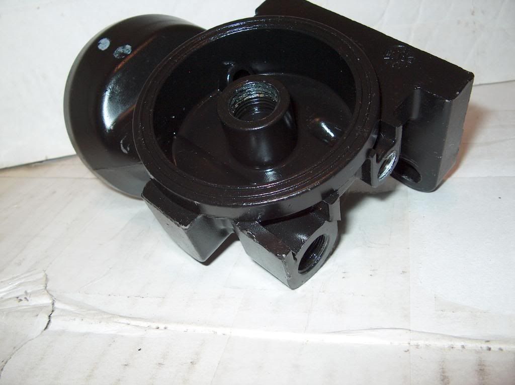

For those whose interest is piqued, that's the Inlet Fuel Temperature Sensor that is strangely vacant from it's assigned berth, having sought other employment, elsewhere................
Check elsewhere out, here:
http://www.lostjeeps.com/forum/phpBB3/vie ... 927#320927
'05 CRD Limited
Pricol EGT, Boost
SEGR; Provent; Magnaflow;
Rubicons, 2.55 Goodyears

You are correct, Widowmaker - all the above................
That is the plan, CX - plus, the rejected items on either side of it - look at Evicted............
The CCV puck has been exposed, Uffe, with show'n'tell - prolly in CRD Tech forum - CCV is nothing more than a high-volume low-pressure (vacuum) regulator\centrifugal separator, intended to hurl the denser oil from the vapor and channel it directly back into the valve cover, and regulate vacuum from the turbo inlet to ~6"H2O at 2000rpm - far as maintenance, ~50kmi would be my rec, due to heat-hardening of the rubber diaphragm..........

 Post subject: Chromalox heat tape in a waffer
PostPosted: Sun Apr 06, 2008 11:40 am
Posts: 3554
Location: Aurora, IL
Chromalox heat tape has been around for many years and has worked well for it's applications like water lines and outdoor equipment contact heating.
http://www.heatersplus.com/srtrace.htm
Take the same technology and put it into a puck and you have what Chrysler chose to heat up our fuel. Loose the fuel around it and try to run it in air bubbles it over heats and fries. Had the bean counters stayed out to lunch and the lift pump stayed on the drawing board, the heater puck would have worked as designed. It is too bad that the bean counters are not held accountable for their actions and have to pay for the warranties and pay for our lift pumps out of their own pockets.
The other over sight with this puck is that the Chromalox heater tape uses a thermostat to shut off the power when it gets over 35f - 55f depending on the application, and this heater puck is left to it's own process to regulate it's self.

 Post subject: Problem with puck design
PostPosted: Sun Apr 06, 2008 10:09 pm
Posts: 3554
Assuming in a perfect world and there is never a air bubble to make the heating elements run dry, over heat, and burn up as did mine that was replaced under warranty.
Then, when the fuel gets too warm from both getting heated up by the fuel injection system and when the heater puck does not shut off, the ECM cuts back on fuel and reducing power out put.
Placing a fuel cooler on the return line for hot weather operation and a thermostat on the filter head to shut off the heater would solve the problem.
Members who run in hot climates will unplug the heater and only use it if they are going to travel to cold destinations.
Assuming the self regulating heater puck works as well as a Chromalox self regulating heater tape, I will still be cooking at 100f, I know I have had electricians hook the thermostat up NO instead of NC and people have gotten their hands burned. For some reason my hands are more heat resistant giving me time to get my hand off the heater tape.
Even at moderate temperatures, if the PUCK DRYS IT FRIES :!: :!: :!: :P :P :P :P :P
As did mine and other members :!: :!:

#2son's oem fuel manager head\heater puck did not fail, Rob - this is just show'n'tell - intent, purpose, and scope of this thread is to define the operational and failure modes of the fuel heater puck with it's intricate internal intricacies - this thread is resulted with the replacement of the now-useless primer pump and difficult to replace filter element and possibly defective fuel heater module with a better fuel manager head, DCJ-approved, top-loaded for convenience, here: http://www.lostjeeps.com/forum/phpBB3/vie ... 927#320927 - the fuel heater is t-stat controlled, and the entire unit is for an engine with greater fuel rate than ours - it's mo' bettah, works fine, lasts a long time - just another viable option for improvement of the little orphaned mule.........
