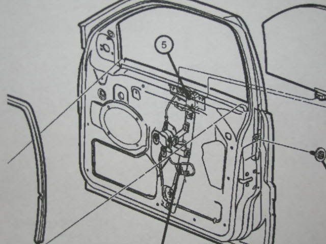

My window was making a lot of noise going up. The service manager said they do that right before they break. As I stated in the first post my passenger side front is going also. It is noisy! I think I'm going to take it apart and have a look.
PostPosted: Sat Aug 16, 2008 5:00 pm

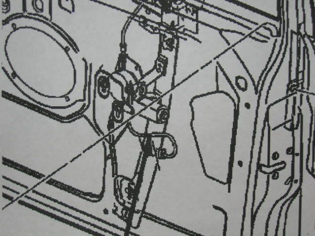

Here is what this mess looks like. The regulator is the piece in the middle. I don't know which piece is the "plastic piece" that breaks.
