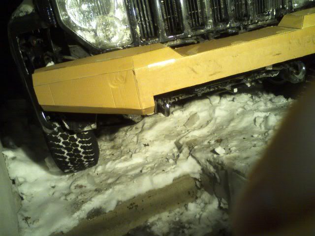

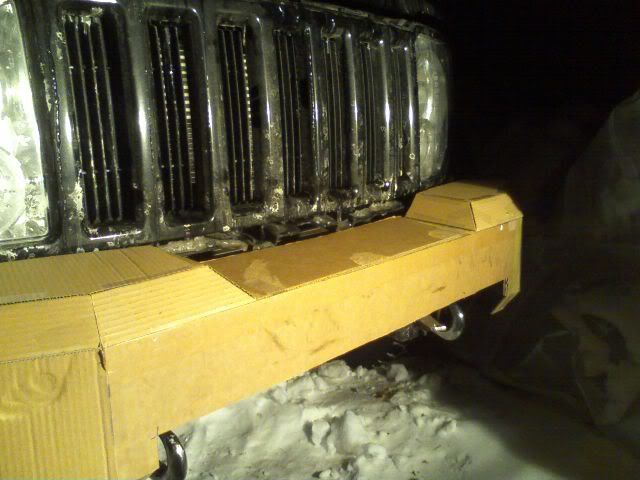

Im building a steel bumper to mount my winch. So far I made this cardboard bumper for a test. What do you think about it.
The sides are not done yet and also the part that goes under the turn signal light but that already give a good idea of what it will look like
the winch will be monted on the bumper and not inside like arb
All opinions good or bad are welcome
08 KK north, select track

there will be 2 shackle mounts in front. I might add holes on the sides for lights or mabe a bar over the winch if it looks good. the top part of the bumper will be a winch plate with fairlead mount. I will buy steel this week and start working on it. I expect it to be finished in 2 months depending on how much free time i get.

3/16 tick cardboard :lol:
at first I wanted to use 3/32 but going to 1/8 will add only about 10 pounds so it will be 1/8 all around except the winch plate 5/8 and frame mounts 1/2
wow thats definitely gonna be beefy, if you want to save some weight 1/4" is plenty for the winch plate and the frame mounts

Looks like a good start but I'd be worried about hitting a rock dead center and breaking the powersteering cooler or worst yet the radiator without some kind of bar at the bottom to protect it.

Radiator skid just like the Liberator II ;-)
yep there will be a radiator skid built in the bumper mounts

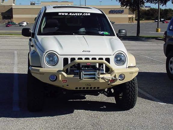

Here is a pic of my Trailready Front Bumper and Warn 8000i winch...for some ideas. This was my first Liberty 2002. This bumper with hoop was ~110#...turn signals were mounted behind the slots on each end of the bumper. 3/16" skin...1/4" elsewhere...thick shackles that passed thru the front skin...
