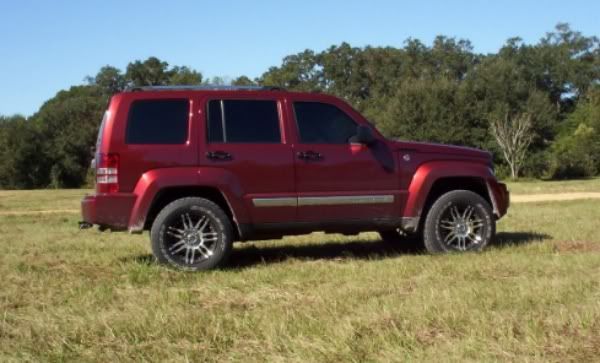

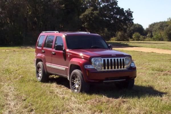

I take it the first 3 photos Digger posted for you are the 265/65R17 tires (10.4"W x 30.56"OD) that you mentioned were mounted on 17"x8" rims with 5 1/4" backspace that you have no rubbing issues with your 2" lift?

First off: YES, the first three pics are the 265/65R17(x8) on 5-1/4" BS
I have NO rubbing issues with this setup. I have not been too far off road but I have crossed a couple of ditches and a couple of concrete medians.

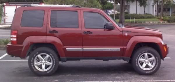

Second: those are 285/70R16. They equal out to 33x11.50 and NO they do not fit under a 2in lift. The back I don't think would have a problem, but the front would need some serious modifications to the wheelwells.
I bet with Rock Lizards (in the works) long rocker guards and some bumper modifications it would work. Now mind you those are 4-3/4" BS rims that I tired on there. With a slightly narrower tire and a little more BS there might be less trimming to do.

:oops: My Bad: Bridgestone Revo's - 285/75-16 still same size quoted though
They only stuck out from the flares probably less than an inch :?:
But there was no room what so ever for the tires to turn. The wells would have taken a pounding. As far as closeness to the ubj it wasn't that bad I was able to get my skinny fingers between them.

ok first 3 are his new 17's
#4 this is his bro's 33 off of his TJ

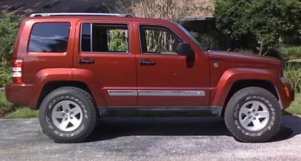

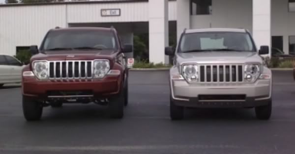

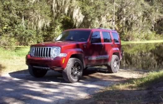

5 and 6 are the stock rims after he did the lift

unclejjg wrote:
So 08-FL-KK, do you think the tires would have fit better with the stock wheels?
:arrow: I am assuming you are asking about the 33s on the factory offset wheels. No, they still would not have fit because then they would have been up against the uca. The 265/65 on the factory wheels gave me just a slight more room in the wheelwells but it made them look too small. I was considering a 265/70 on the factory wheel though. I think those would have fit no problem, but that would mean a little more loss in power (ie: mileage). Then I saw these aftermarket wheels and the new tires were out.
