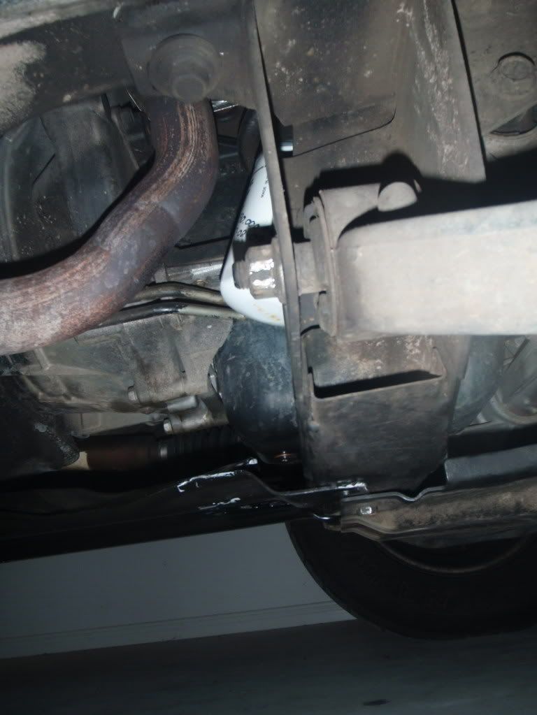

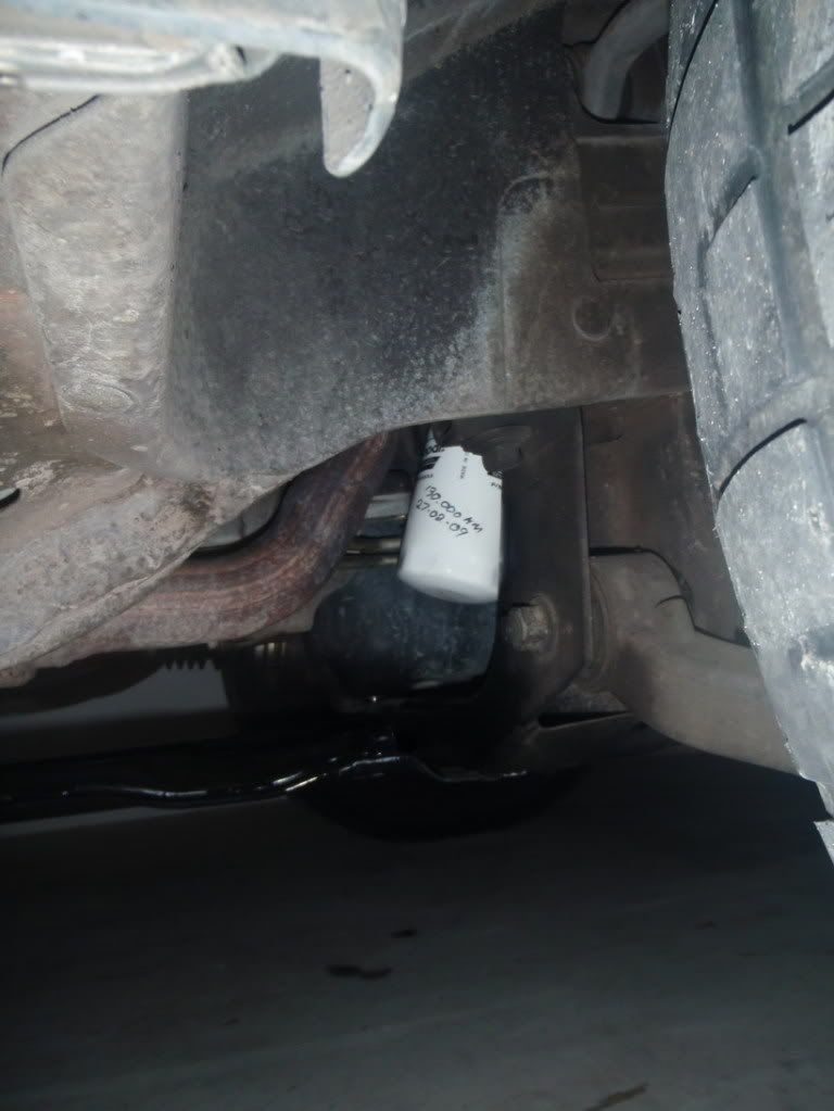

CRD owners will know that their oil filters are hanging down in the breeze, and even with a Transmission skid plate are still exposed to direct upward or diagonal damage. Yesterday I pulled the Tranny skid out of the garage to remount for Camp Coffs and I decided to do a quick mod to the skid to provide protection to the oil filter. I had a few old pieces of 4mm steel chequer plate which I welded together and hammered to fit the side of the plate - basically constructed a 'wing' that extends diagonally outward to protect the oil filter. The photos that follow show how it turned out, which I think is a massive improvement on the protection afforded to the oil filter. Yes, I know the 'wing' will probably not support the weight of the KJ if hung up on a pointy rock (especially with my welding), but it will stop sticks, branches, and kicked up rocks, etc.

I have a few dings on the trans skid near the filter... not the type of thing you want to knock off in the bush.
Can you remove the filter with your 'wing' on the skid?
PostPosted: Mon Mar 30, 2009 2:36 am
Posts: 1520
Location: Australia
Yes the filter can be removed with the skid in place, however I usually leave it (the skid) off when I am in the city. I put a hole in the lower part of the wing to drain water, mud, or oil that might pool there. I would not want to change the oil with the skid in place (although it is possible).
