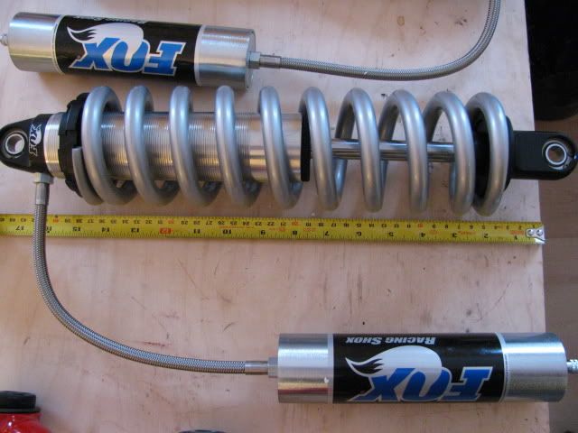

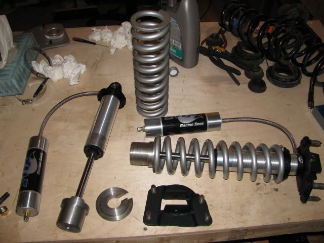

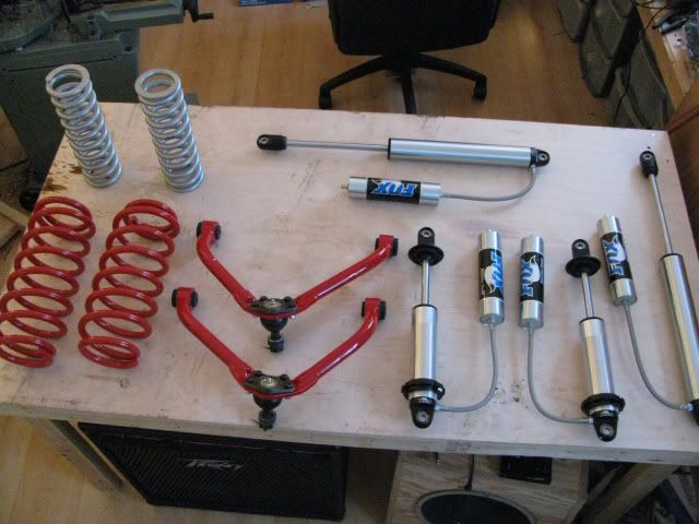

Well I just got most of the parts for my lift :D
got:
JBA A arms
JBA 4'' rear springs
Eibach 12'' 500# springs
Fox Coilover reservoir 5'' travel
Fox shock reservoir 10'' travel
still missing:
custom hardware to fit the coilovers
extended brakes lines
new cv axles
pics of the finished product in 3 weeks :D
08 KK north, select track
12k titan winch
3'' fox lift, Jba A arms

what is the travel on the jba 4" lift kit? and even if say the part had 30" of travel what is the max for the kk with out more mods ie: disconnects
PICTURES OF MY RIG
PostPosted: Sat May 09, 2009 7:49 pm
Posts: 431
Location: canada
rear shocks on the jba 4 are 10'' travel. In front I dont know but I guess they are close to 4''. I would say that those numbers are about the max you can go without some serious mods.

Thanks. So what makes you go for these fox parts?
PICTURES OF MY RIG
PostPosted: Sun May 10, 2009 2:57 am
Posts: 431
Location: canada
better overall quality, you can tune them to your tastes and around 20% more travel in front
did i mention my kit cost me 500$ less than the jba 4'' :shock:

Posts: 431
Location: canada
E2 wrote:
NO tell me more.....
:lol:
http://www.offroadwarehouse.com/product ... 3/sfID3/98
1000 $ for 4 shox and 2 springs
600 $ 4'' jba springs and a arms
less than 100 $ brakes lines if you shop around
well I should say that MY cost is 500$ less because Im fabbing the adapters my self for the front shocks. That would be at least 300$ at a machine shop but you could replace the reservoir shox with emulsion shox and save 220$ and still have 90% of the performance.
the real bummer with this kit is I dont think the stock axles will handle the 20% more travel and that is why I have new axles on the way. that will more than offset the cost difference but imho Its still a much better deal than the jba4
my kit sould be rolling in a few weeks so keep looking in this tread if you want to make one for your self
