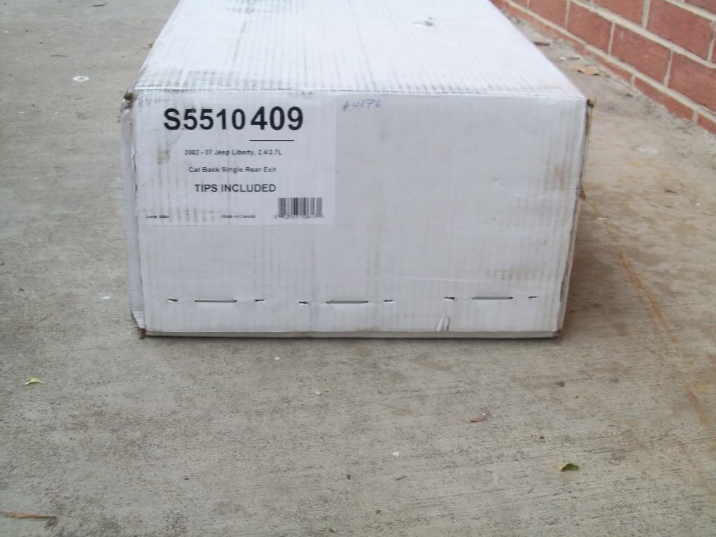

Boxed End w/ Part Number for the SS Version

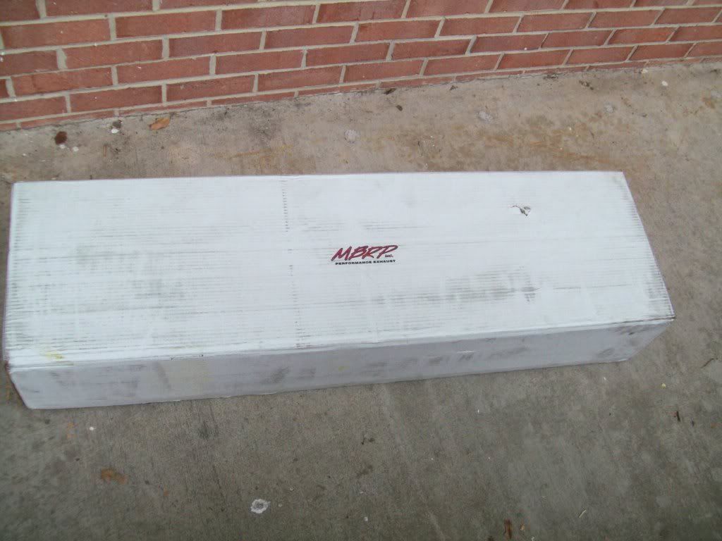

Packaged very well. No parts rattling around.

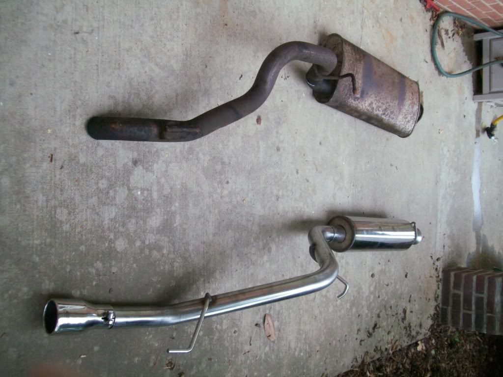

The two exhausts layed out next to one another.

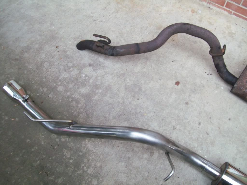

Tail Pipe Camparo. The MBRP does have a bit more of a higher bend. To get this part on, I had to move my jack stand to the body to lower the axle and 'open up' the coil spring and work the exhaust hanger through the spring.

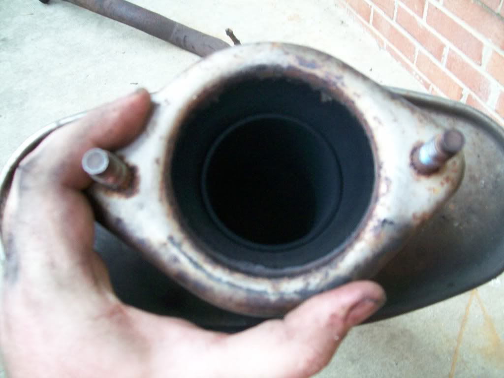

Looking down the stock muffler and its 'choke' point.

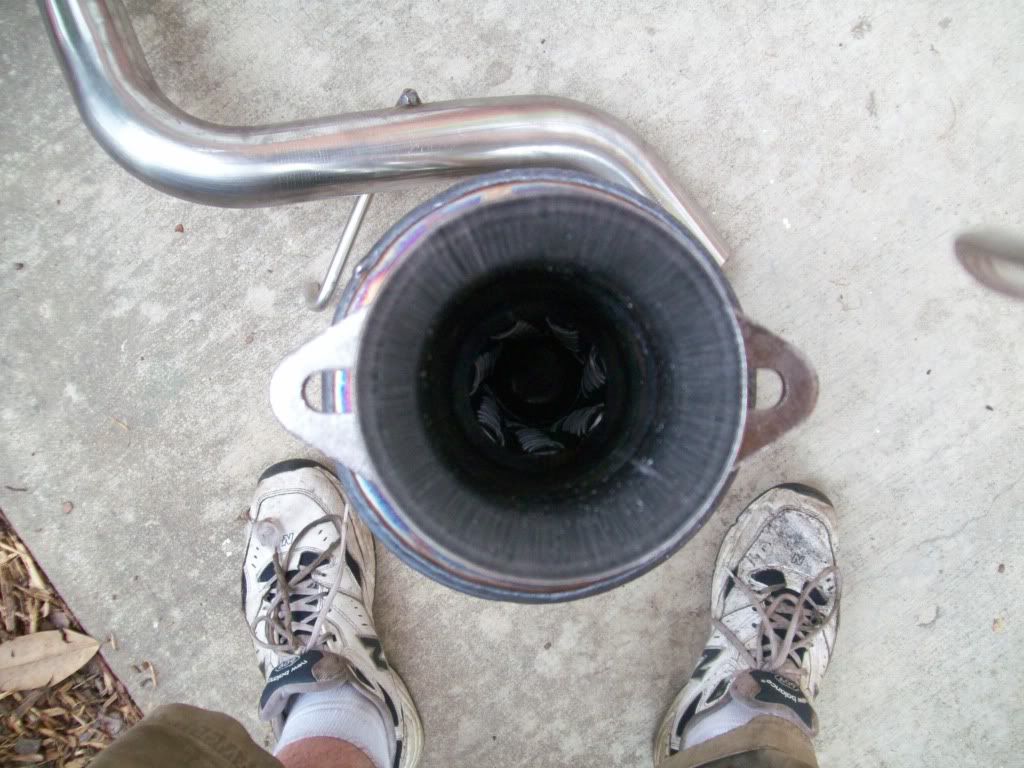

Looking down the MBRP muffler

Izzat a optible collusion, or is that MBRP choke-point just as bad as the original? Muffler id should be same as pipe, straight thru, inlet to outlet - that one appears to be more for the gasser (patooie!) versions, which to them wouldn't matter, long as it's shiny...................

I didn't get out the measuring stick, but the ID is about the same as the same as the cat outlet ID.

I'm still seeing a neckdown just inside that flared flange, then a second neckdown just B4 the diffuser upsets in the main pipe - those are the silencers - woulda helped if the muff had been up off the cement so the backlite would illuminate the details - anyway, post how that works out fer ya, economy-wise - losing that oem restriction should net a little better fuel mileage - now.....who's gonna crawl up under there and keep it polished fer ya?

That same inside look, those louvers, create a standing wave effect, which blocks flow. On the dyno, it cost us over 50 hp loss. We put a straight pipe on and got back our 50 hp. Next we put a Flowmaster on, no loss on hp. (Flowmasters have baffles in compartments, no louvers).
This was on an off road car, turbo'ed.
If it works ok on a CRD, then the only thing that might be happening is that the length of the pipe is much longer before the muffler than on the off road cars.
I know the argument that "I can see right through it," but remember that the exhaust is spinning like a tornado, not a laminar flow, yet.
I guess the best test is dyno before and after. That is where the proof is.
