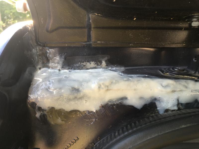

I updated the thread to answer some of your questions and help other people down the line. Here’s what I wrote:
It has been several years since I sealed the roof, and it was fine for quite a while. I started getting leaks in the same place (see above post) again this year, but also noticed that the sealant across the sheet metal seam above the liftgate opening was cracking (probably due to vibration and expansion / shrinkage of the metal with temperature changes). This time I went nuts with the Rustoleum version of Flex-Seal and slathered it across the entire seam:
I know, that’s UGLY! But it does work. It is almost 99% leak free again. On very intense and long rainstorms there are a few drips from the center trim panel, so I probably will have to take the roof rack off again and reseal around the sidebar feet.
Rust-wise, I can’t see that it has gotten any worse. I encapsulated a bit of rust with the sealant the first time, and it has most likely grown a little, but nothing to make me worry.

To answer your other questions:
I never had a leak at the sun visors but I did have leaks on the headliner above the driver’s seatbelt area, which correspond to the front attachment points of the roof rack. The seam that is the issue runs the entire length of the Jeep under the plastic black trim line but it gets stressed out at the roof rack attachment points. It’s possible it could be leaking in front of the forward roof rack bolts, but it could also be leaking at the bolts and then water could be traveling forward inside the Jeep and coming out at your sun visors. I would say that might me more likely but you know your Jeep better than me.

Hello!
Actually I think the 3M product is way better. I had the flex seal stuff left over from another project and my local hardware store didn’t carry the 3M. It was totally a decision of convenience. I think the 3M looks better and is more durable. It would get my vote. Just leave the roof bars off for a week and it will be fine.
